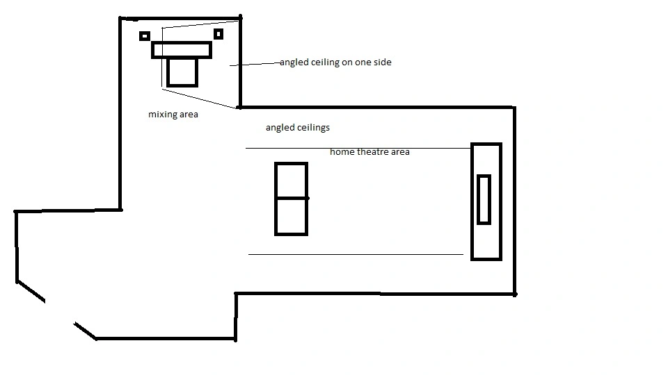

I have a little treatment at the early reflection points, but I need opinions on where to put bass traps and/or additional treatment. Thanks for your help. I've attached the layout of the room. It's not optimal as a mixing room, but it's what I've got.

If it's at all possible, I'd switch the "home theatre" area with the "mixing" area. Where you have the mixing area now looks a lot narrower than the home theatre area.
Thanks, Rami. I wish that were possible. The entertainment center is huge.
I don't think I asked the question very well. I realize corner bass traps are needed, but I'm not sure if I would benefit from every corner having one in this room. Anyone?

Ah, yeah that's what I thought. That theatre desk looks pretty wide.
You can never have enough bass traps, really. I think it would take lots and lots of bass traps in any room before one would come close to reaching the point of diminishing returns. Don't forget the floor/wall and ceiling/wall corners, too. Not saying you HAVE to cover them, but as long as there's an exposed corner, there's room for a bass trap. :)
I would bass trap the front corners heavily (with something like Superchunks/TriTraps or Soffit Traps). The home theater corners likely won't give too much of a noticed effect in the studio (but, you could always treat the home theater space too!!)
Considering you don't have much corner space by you, I would probably additionally trap the wall/ceiling corners around the mix position (along with the first reflection points).
Since you don't have too much space for tons of traps - make them all thick as possible so they're all able to absorb any resonances. Luckily, with the odd room shape, you shouldn't have as intense of problems in the bass as some small square rooms.

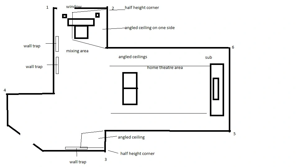

Attached is my proposed layout. I'm thinking superchunks in corners 1-4 (possibly 5 and 6) and wall traps in the designated wall areas. Would this be a decent plan of action? Will the half-height corners benefit me much? Also, should the wall traps be 2 or 3 inch thick?
I'm also thinking about moving my mix desk away from the wall a foot or two; would that help?
I would skip 4, 5, and 6. If you can, get some absorption on the wall/ceiling corners around your direct position.
Why can you only go half height in the front right corner anyways? But yes, it will be much better than nothing.
As thick as possible really. And an extra air gap is helpful too. For reference, our slimmest bass trap is 5.5" thick. I don't really consider any traps thinner than 4" to give any significant bass trapping at all.
It might but it might not. Experiment with your desk/speaker placement a bit till you get the best response.
Also, I would heavily suggest putting panels on your right side as well to get a more even stereo response. I'd immediately change that. I know there isn't a wall there, but I would build/buy/acquire some stands for them. Lots of reverberation on your right and dead on your left would be really awkward.
That's what I was hoping. It gets to be expensive.
Half height is where the angled ceilings meet the corner. It's really about a 5ft corner on corners 2 and 3.
Will do. Thanks.

Thanks, jimmys69. I found Roxul safe n sound 3" panels(roughly 2'x4'x3") at a store for about $20 cheaper than 6 panels of the 2" RXL80. Is the safe n sound okay to use?
I'll have to get creative with my frames. A lot of weird angles and spaces to fill. I'm not really sure to do about the window that butts up to the corner right in front of my mix desk (Corner 1 in my diagram).
Yes, Safe 'n' Sound will work. If you can on at least some of the panels, doubling them up to be 7" thick instead of 3.5" would be better for bass absorption. Safe n Sound is a bit light so, for thinner traps, the Roxul 80 would be a better choice, but for thicker panels, Safe n Sound would be best. (They will both work in either thickness though, just a matter of efficiency)
