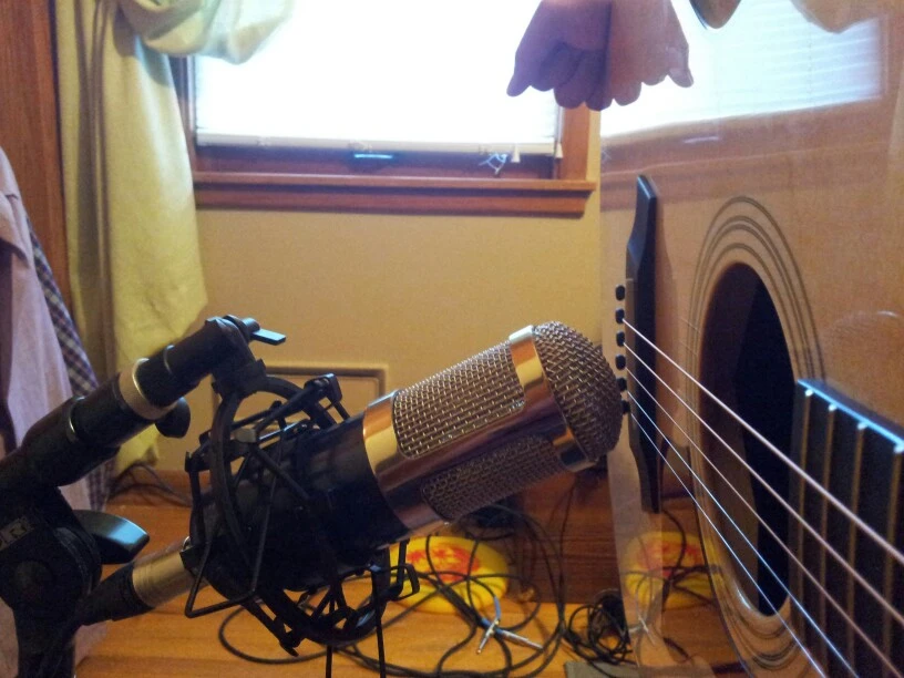

I'm trying to get started recording my acoustic at home on Abelton Live and would like some feedback. Please point me in to another area if this isn't the proper place.
I'm using an MXL R144 Ribbon mic that plugs into an M-Audio Fast Track USB interface that goes into my Mac's Abelton Live application.
The main issue I'm seeing is that the output in Abelton is VERY low and I have to throw the Mic gain on the M-Audio up to full. And anywhere else besides right near the hole on my acoustic gives an output that is extremely low.. so i can't even really try to apply the "placing the mic near the 12th fret" theory or other placements to experiment with different sounds.
Any inputs or ideas of what I may be doing wrong/missing would be appreciated!

I'm pretty sure you've pointed the mic at the floor and ceiling.
Ribbon mics are figure 8, so they pick up from front and rear.
You've aimed your mic as if it's end address, like an re20 or md421.
Sooo you're basically saying just point it upwards/downwards instead of orthogonal to the soundhole?
Thanks!
Yehp. Simple as that.

And congratulations on asking a concise detailed question with illustrative pictures that allowed a simple diagnosis... you'll go far.

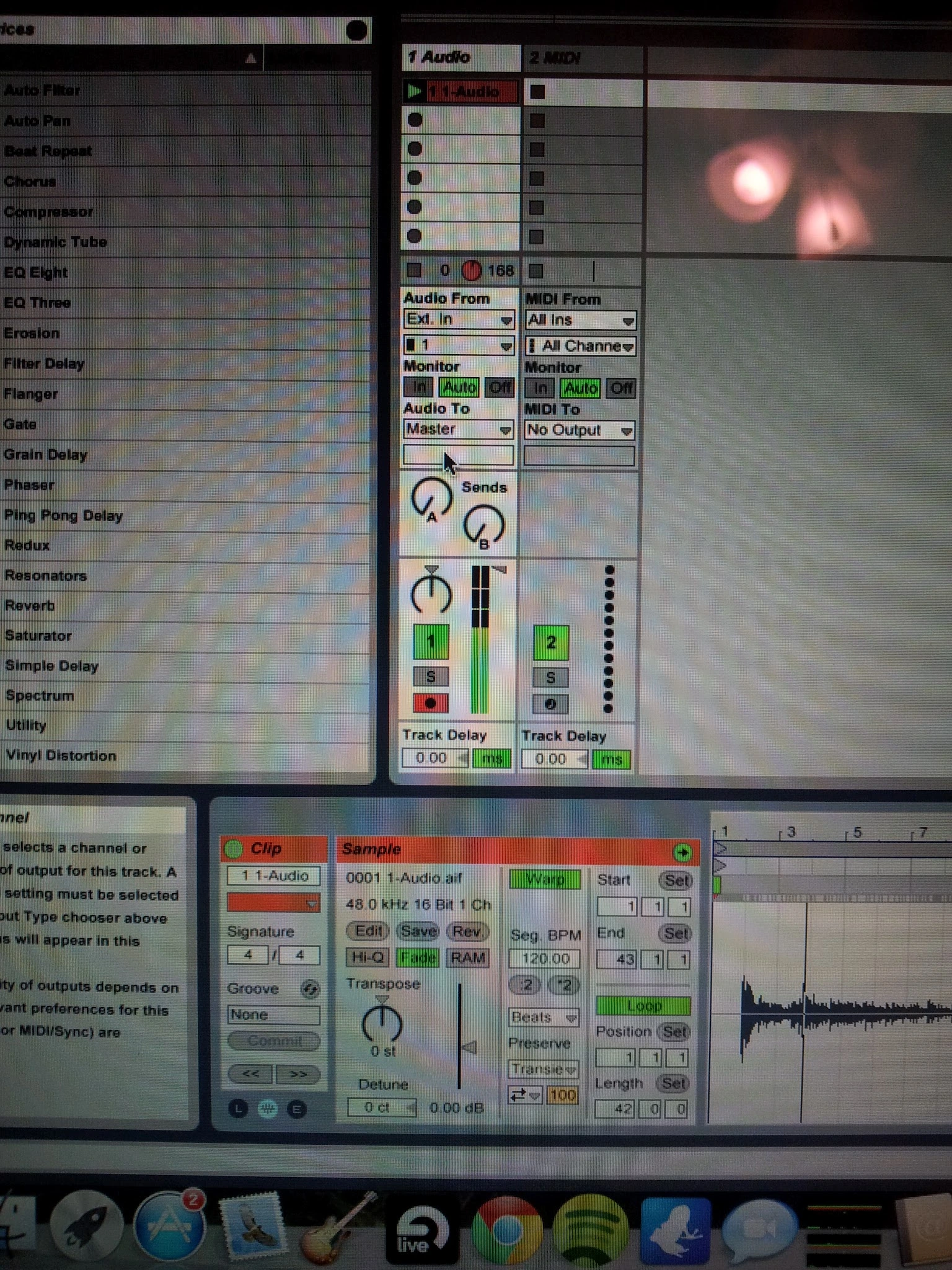

Btw, I forgot to mention, your levels look healthy enough.
I mean, sure, definitely point the mic the right way but bring the gain down to compensate. ;)
You shouldn't be aiming for the signal to go near the top of the meter.
Bouncing about in the middle (like your pic) is about ideal.
