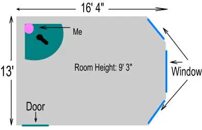

A diagram of the room is attached.

2) Create a recording area in the corner with plenty of dampening by...
- Bass traps behind me in the corners
- Acoustic tiles on walls behind me
- 2 Angled panels directly behind the mic with bass traps/acoustic foam on them
- Bass trap above me to help cut ceiling reflection

Deaden that corner floor to ceiling and on the ceiling with normal R-13 insulation and cover with cloth. Make some movable panels that are plywood on one side and filled with insulation and covered in cloth that you can move around behind you when you want to make a 'temp' booth. When not, move them wherever.
Wont it be better to have cloth on both sides instead of plywood? Means much lower frequency absorbtion as the distance from the wall is much greater
