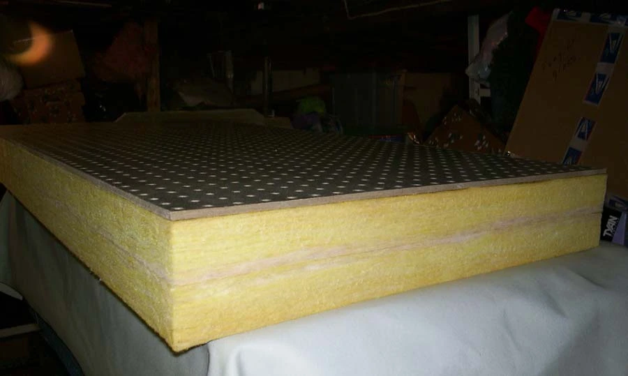

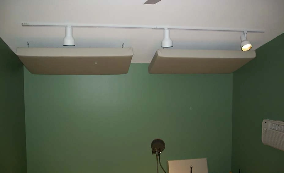

Incidentally, I just built some very simple 4" panels this past week the hang on the ceiling in my room. I guess the hip word these days would be to call them "clouds". It's not rocket science to make these as the 703 does all the absorption work. You just have to find a pleasing way to wrap it and hang it. These panels are 4" of 703 ( actually it's knauf brand- 2 layers of 2" ) on a 1/4" pegboard wrapped in fabric and stapled to the back. The pegboard is merely chosen as an inexpensive, solid backing. No adhesive or nothing. I put some eyehooks on the back to hang with a light chain 4" from the ceiling. each panel cost about $20.00 USD for the materials to build. They get the job done...
here's a pic

and here's a shot of them hanging
