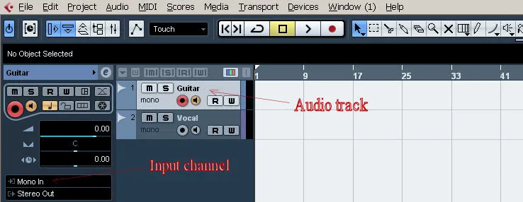

I copied this setup procedures from one of my posts. It is adapted for the Alpha:
You must first select Lexicon Alpha in Cubase. Devices>Device Setup...VST Audio System. In the drop down menu at top, select 'Lexicon Alpha' (or whatever it is called). While on that page, check the 'Release Driver' box. This will allow the Alpha to play WMP, Youtube, whatever, while Cubase is open.
Now, go to Devices>VST Connections (F4 shortcut). Add a mono input bus. You will need to create a input bus for each input needed from the Alpha. For each input bus created, you will left click on the 'Device Port' column (highlighted in yellow), and select the input channel of the Alpha that you wish to use. Leave the default Stereo output bus.
Now, create a track to record to. Project>Add Track>Audio>Mono.
In the 'Inspector' window at the left of the main project window, look for a symbol that looks kinda like this: >] SEE ATTACHMENT
This is where you select the bus you created in VST Connections. You will change this on each track that is using a different input channel on the Alpha.
If you don't see the symbol, click on the track name at the top of the Inspector window to pull to the main Inspector screen.
You will need to also toggle the monitor button on the track to hear the input (it looks like a side view of a speaker). Toggle it back off to hear playback.
--to make this toggle automatically; File>Preferences>VST. In the Auto Monitoring drop down menu, select Tapemachine Style.
Let me know if this gets you up and running.
If you don't see the symbol, click on the track name at the top of the Inspector window to pull to the main Inspector screen.....
Don't see the >] symbol and clicking pulling on the track name in inspector doesn't reveal it.
It gives me a screen that says
Inserts
equalizers
sends
channel
Click on the track name-right above where it says 'Inserts'. You will get the screen that has the symbol. It will look like the attachment I posted....
Sorry, clicking the track name "audio 01" in this case, only toggles open the window in inspector that shows the record ready and monitor button. There is a little symbol next to "mono in" that looks like this ->] but it's not a clickable button.
That's what I see in the picture posted above.
Left click on the name next to it. Once you make your connections and input buses, you select them from the drop down menu there.
Sorry I'm just not following I guess. If I click on mono in (which is next to the->] symbol) I get choices of no bus, stereo in L or R. Mono in or mono2 . Tried them all with same results.

GOT IT! What a difference a good night's sleep and a couple cups of coffe make. I wasn't setting up my VST connections and bus the right way.
