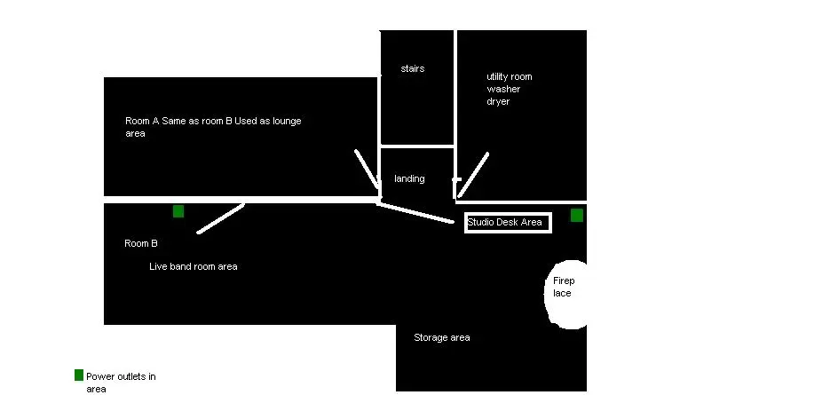

The room is an open style basement where I'm basically confined to an open area, well 2 walls one being 8' and the other being only 6' the rest is totally open for about 14' directly behind me and 28' to the left of me, where there's another open room.
I was thinking based on where I'm located if a plywood wall with 705 or 703 would be a good idea. Something with a curve or some type to sort of isolate the area more.

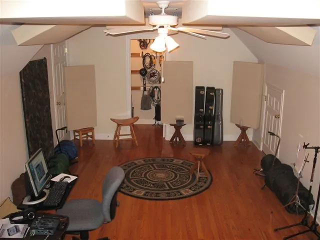

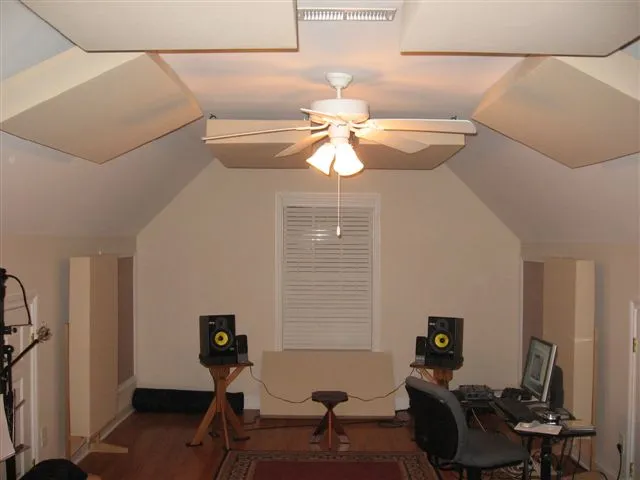

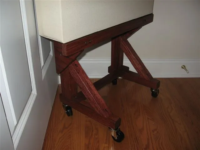

I have 5 bass traps on plant stands or rolling stands. Highly portable.
I like the rolling stand option. I am getting materials to build Gobo's and Bass Traps. I found a few links with great detail on construction.
The one thing I'm not 100% sure on is the location of the desk in relation to the room. I'm trying to relocate the control area to a more suited spot, other than the corner of a large open room.
I think I would look hard at putting the desk on the left wall in your sketch (narrow end of room) in Room A or B, with speakers firing down the long dimension.
Thanks gehauser, I had to do some sweet talking but we have moved the desk to a new area of the room and are in the process of building the gobos and bass traps. We have 2 completed and hope to finish the room within the next month.
