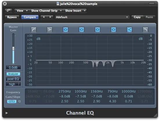

That's certainly a step in the right direction. What did you do? I'll take a guess that you notched it at 3k and shelved it around 7.5k?

guitarplayr82
Essentially - I just searched for annoying frequencies on some of those belted high vowels and started hacking away at the upper mids.

For a first try, I'd say you did a great job. It's actually similar to the result I was getting in my own efforts. It sounds great in the quiet parts, but that high-end gets a little harsh in the choruses.
guitarplayr82, Thanks for the info. I had done similar things, but my low-mid started to get very pronounced. Your's has a little of that, but not as bad as mine had. I don't think I did anything below 1khz except the HPF, so that's probably why. Thanks again.
