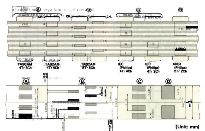

See...
See in the center/left of this diagram the differences between the 8-tr/8-ch and 4-tr/4-ch TASCAM head configuration, (A) and (B), respectively. This picture explains perfectly why the even/odd tracks on a cassette 8-tracker are inherently out of phase, and why if you traded tapes between your Tascam 4- and 8- trackers would result in a phasey mish mash of sound. However, as I said before, some styles of music might mask the phase problem somewhat, but not enough to make swapping tapes between these machines a viable technique.:eek:;)
That explanation glosses over the issue of azimuth and head alignment which would throw another variable into the mix as to why this technique (in OP question, above) won't work. The alignment tolerances are very tiny and most critical to success of these formats.
