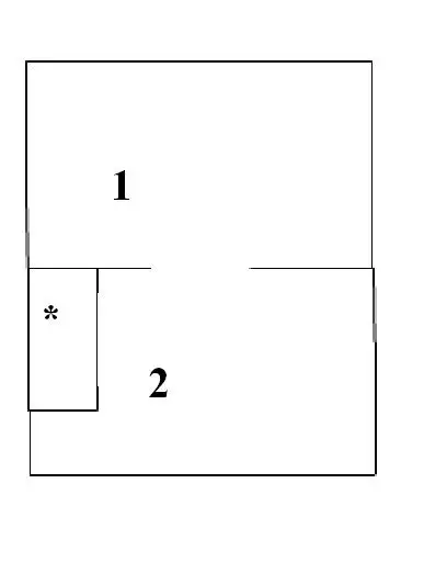

actually im not sure of the application i would have for it...
ok maybe you can help me
my room is small but big enough to have a drum kit and some extra space. it actually sounds nice (never recorded in another room so i actually dont have a thing to compare) but what i hate is the reverb i can hear when i clap my hands (its not much but i hate to record knowing that is "there")
im clueless about materials so i dont know if 7**, rockwool (whatever it is), sheetrock or a miracle would help me get a better room
so if you or someone else have any comments id be glad to hear them
thanks
*memo*
Well, we can run the modal distribution of your room and find out what the problem frequencies are.
From there we can choose the appropriate acoustic treatment for the attentuation of those problem frequencies.
So, what are the dimensions of the room you're treating?
(Length, width, and height.)
hey
heres a crappy drawing and the measurements
1 = 3m x 3m x 2.5m
2 = the same (minus the * area which is a closet)
theres a door frame (but no door) between 1 and 2
all measurements are in meters (dont know how much a foot is :S)
