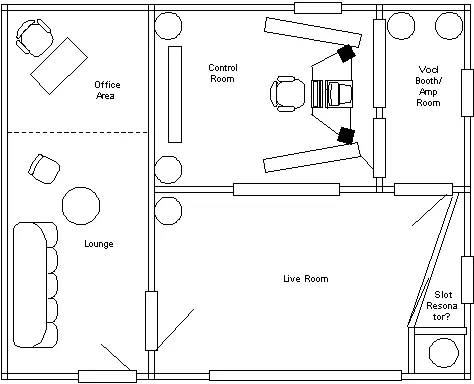

update (turn it around)
Thanks to Mr. Sayers I've now got a nice pretty drawing of what we'd like to do. I've attached my drawing as well. Basically we're going to move the control room to the larger room nd use the smaller one for vocal/amp room with larger "live" room.
