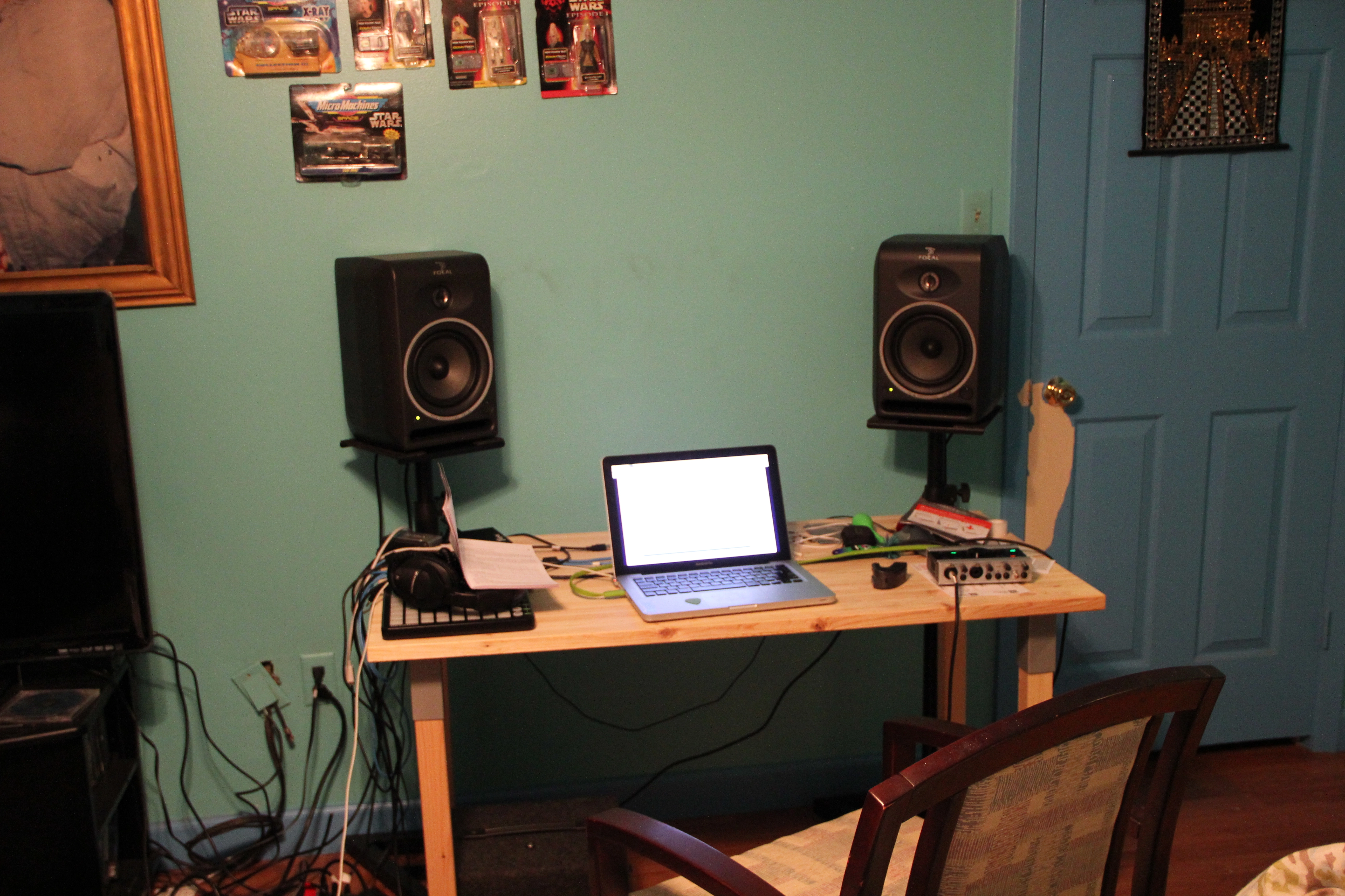

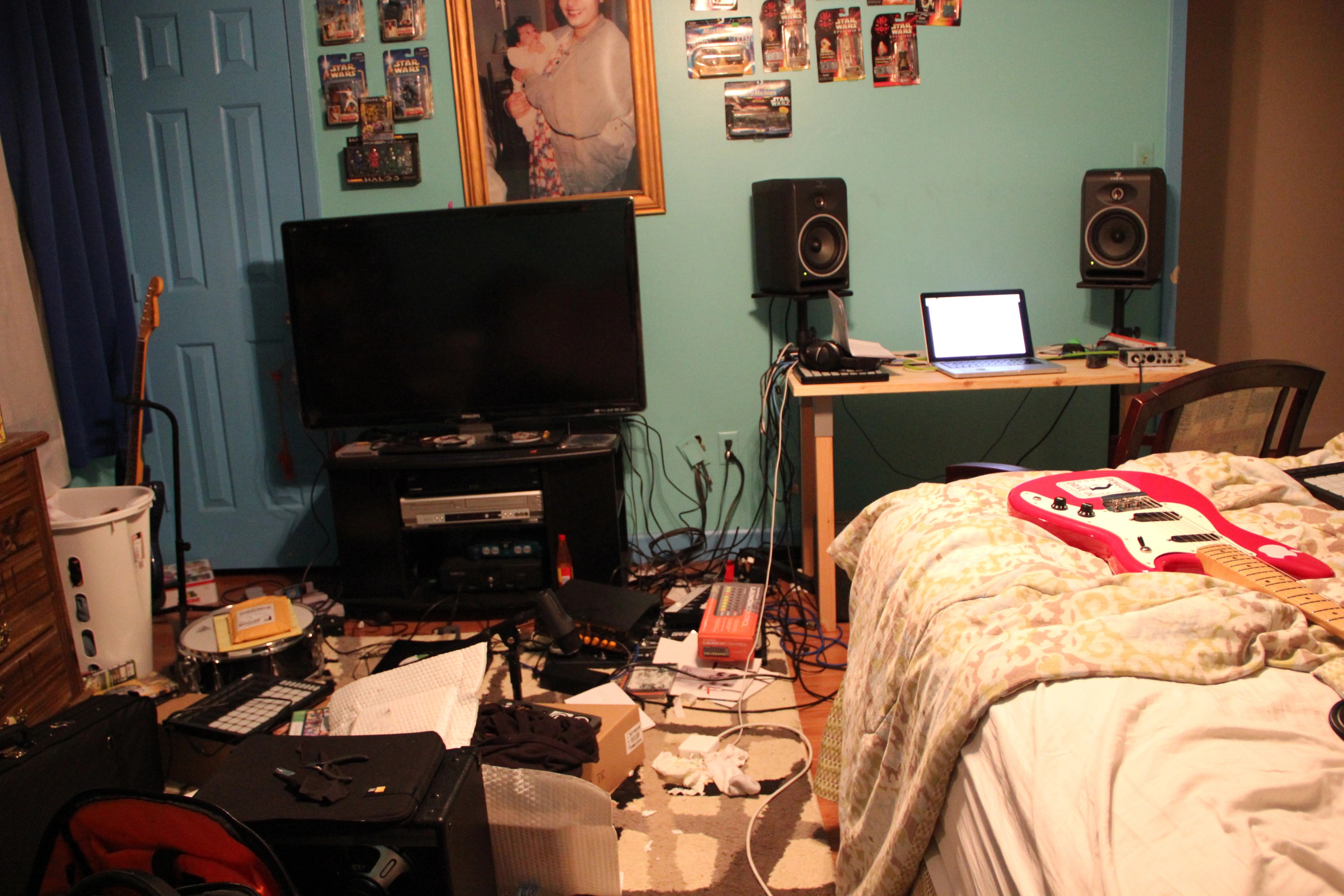

I'm on some onstage stands (see pic below) - do these create reflections?

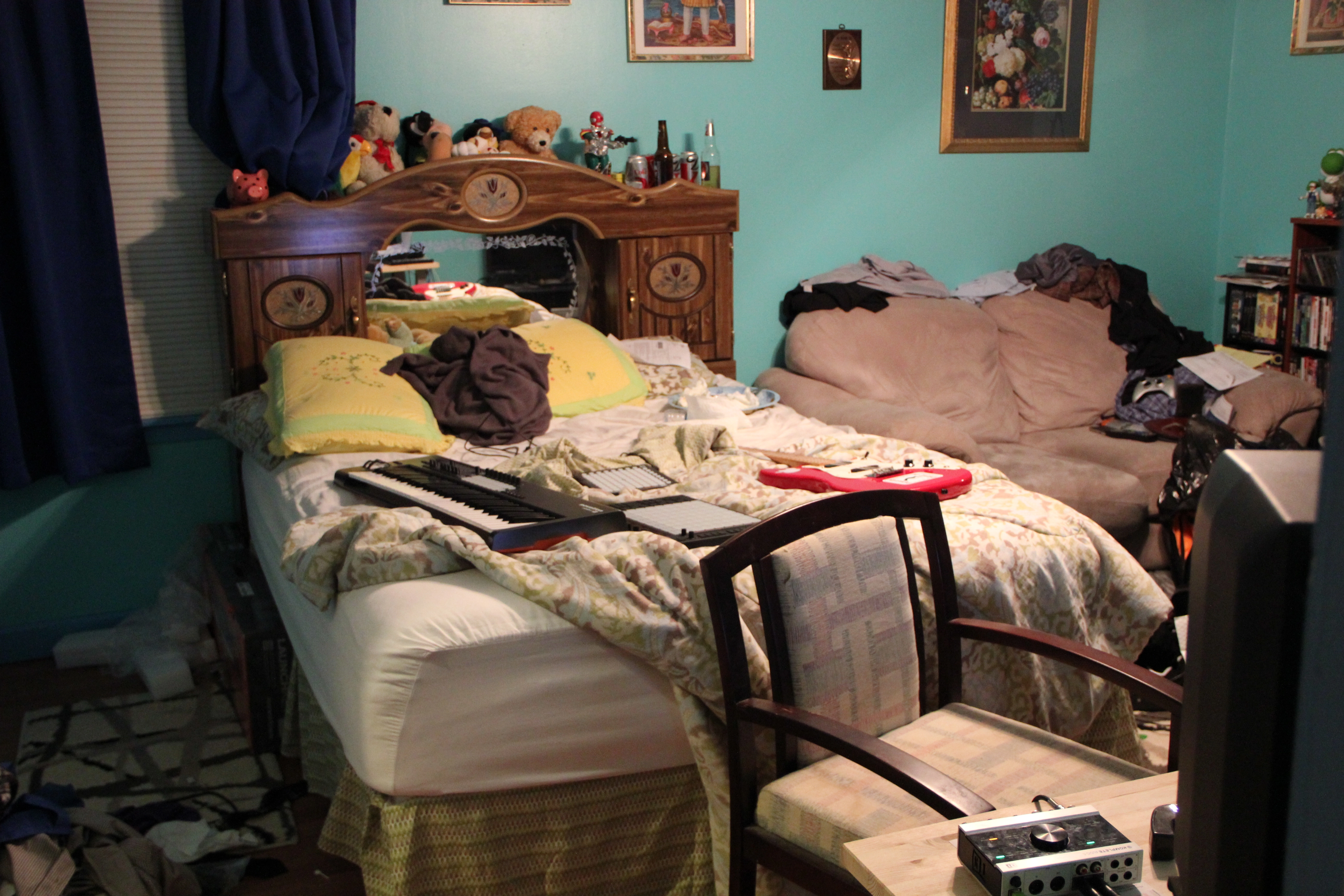

Also, please excuse my room looking like hell.
1. No.
2. Depends on the output level, but +4 sounds right if it's a balanced connection.
3. Leave the HF/LF EQ switches at 0 for now and get use to the monitors a bit. Then take notice how things are sounding to you overall and adjust as desired. If too much HF in your mixes on other systems, boost the highs at the monitor, if not enough, lower them...same thing for LF.
4. Same thing for the last switch. It's a wide cut at 160Hz...so, see how things are with a few mixes and take note of that frequency range and adjust accordingly.
Of course....you have no acoustic treatment in the room and a lot of hard/reflective walls....so you might consider that, and make some improvements with broadband trapping.
Fix your bed and clean up your room.
That is one messy room! (You can see some of us our at that age where we do notice those things :cursing: <- parents seeing the room)
