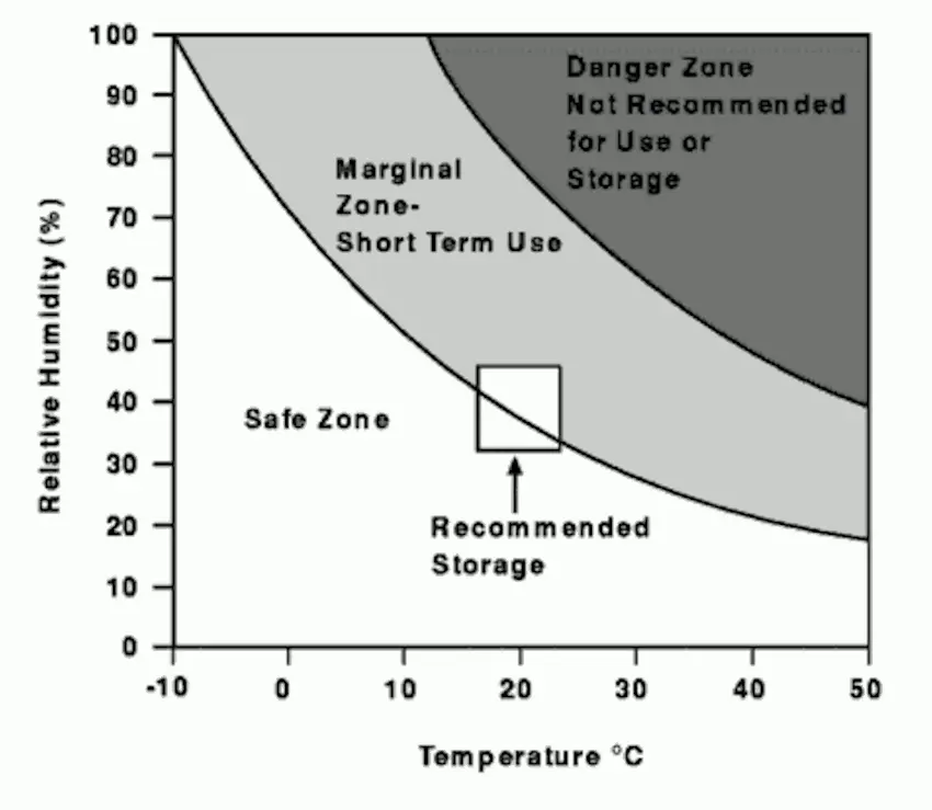

Sticky Shed is a very specific problem, caused when some manufacturers changed the formulation of the binder used to make the coating for the tape to something that was more environmentally friendly thru being water based (rather than oil based, which could have included whale oil ?). The problem is that over time the product takes water back in (if it at all can) and turns to sticky goo. Baking can put the tape back, but this is a temp fix ONLY. All tape made before the start date of this problem - and your tape is well too old to be affected by this specific problem, should be OK - other problems excepted.
