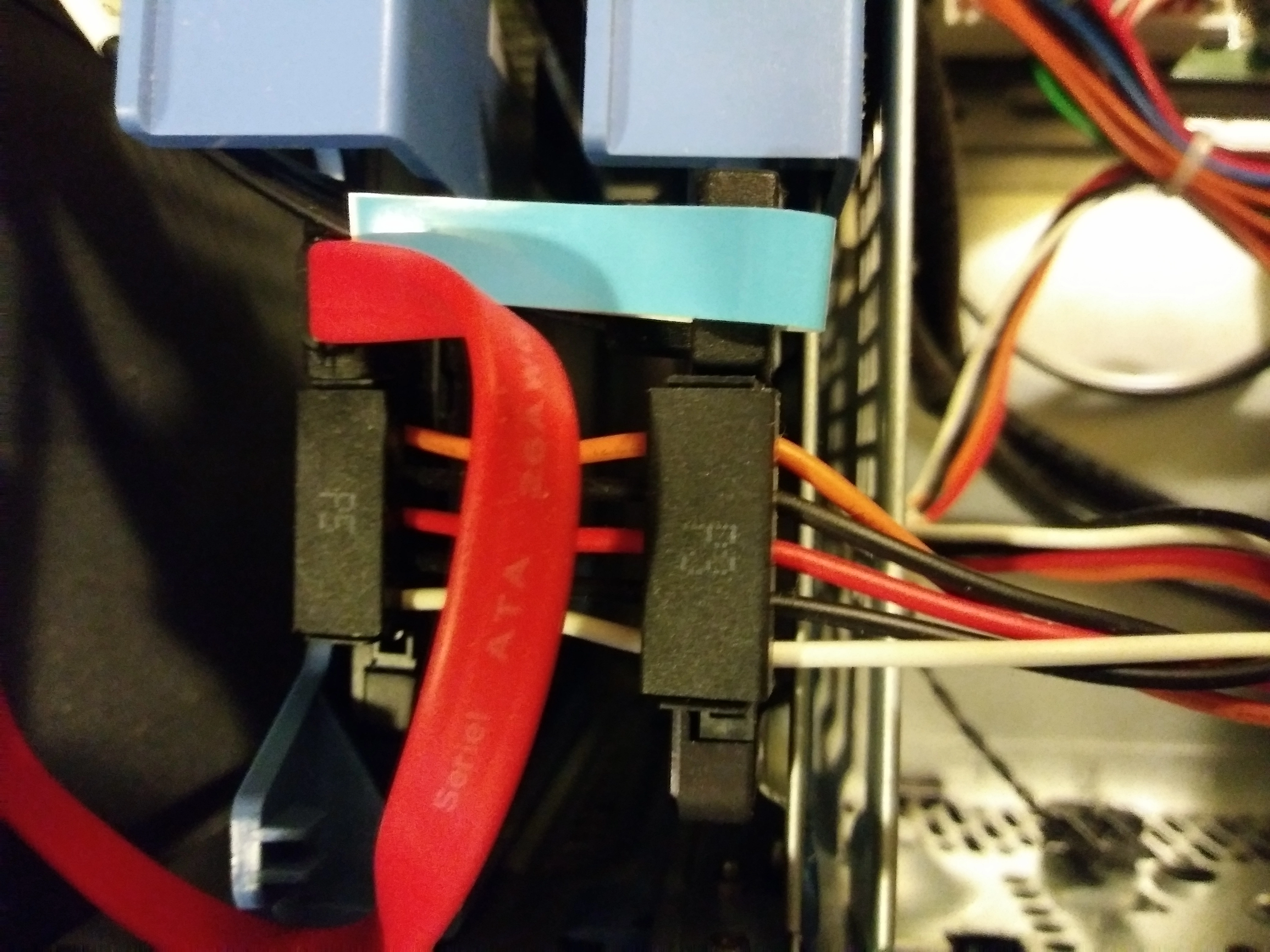

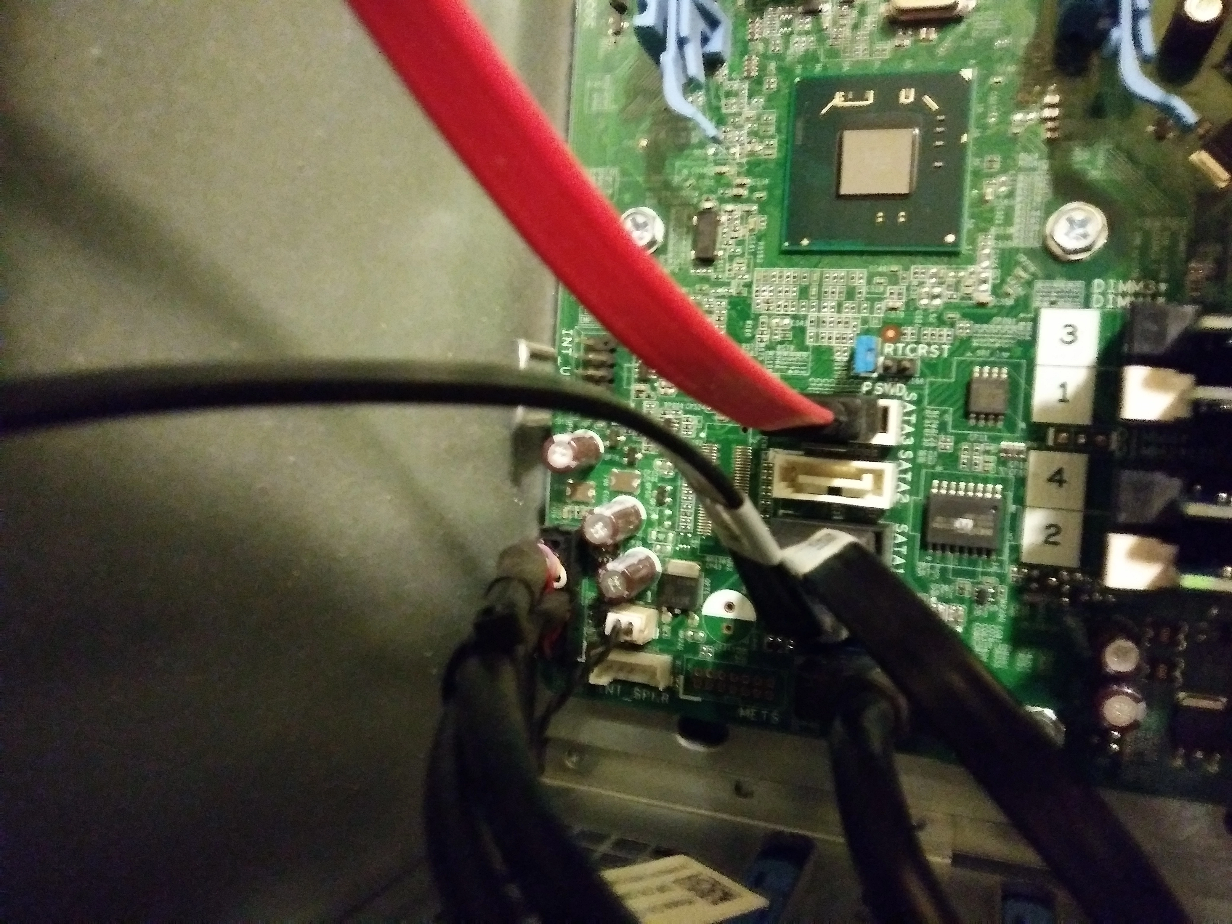

here are some pics. The one shows an empty sata port and the other shows the power hookups to the two ssds currently in the two caddys and bays.I would like to know if those two black power connectors are snap on or do you have to bare the wires? If so where can i get those connectors online? Also you asked about caddys and the answer is that the one caddy on the left holds two 2.5 inch ssds. 20191112_114839.webp20191112_114822.webp

https://www.amazon.com/StarTech-com...ata+power+cable+adapter&qid=1573579401&sr=8-9 could this be what I'm looking for?
Yes, the product you linked will give you four sata power connectors in exchange for one.
I'm not sure whether the pictured ones in your computer are snap on or what, but the splitter you linked is the easy and safest solution.
Your image of the board is different to the images I initially saw when searching.
If you have a manual to confirm, or can confirm through testing/checking, that'd be ideal,
but it seems like the blue+black are Sata III and the white pair are Sata II.
You mentioned two drives but there are three cables so I guess an optical drive is plugged into the black sata port?
If that is all correct I'd go
Blue - System disk - Sata III
Black - Main (most frequently used) storage - Sata III
White - Optical drive - Sata II
White - New storage drive - Sata II.
Please take all with a pinch of salt. It's always tricky finding specs when there are many revisions out there.

One thing that confuses me is the power cable has five lines in my computer but the three way power adapter(not the data cable) i want to order has four lines.20191112_114839.webp
At present you have three devices using three power plugs and, presumably, there is no extra/spare.
If that's correct, you need an adapter that turns one sata power plug into two, giving your system a total of four usable sata power plugs.
The adapter you linked on the previous page would give you more than you need, but it doesn't really matter.
Oh, I see what you mean now...Didn't catch that at first.
Sata power is sata power.
Chances are the two black cables are both ground and the adapter you're talking about just uses one conductor for them.
If you want to post a link to be 100% sure go ahead but I doubt there's a problem. :)

Post a link to what?
It has four electric cords or lines to it. My computer has five. But someone said that one of the four lines served as two.
