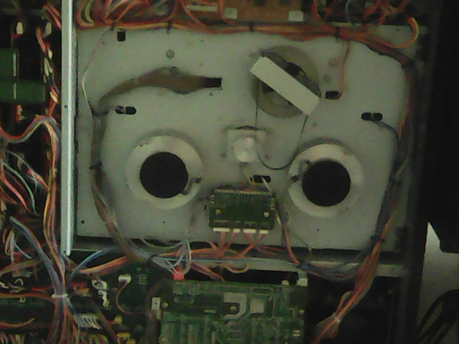

M Mark7 Well-known member Oct 21, 2023 #1 It was working fine a few days ago, and last time I looked at the drive belt it was also fine. What could be going on?
sweetbeats Reel deep thoughts... Oct 21, 2023 #2 When you raise the tension arms does the capstan spin?
sweetbeats Reel deep thoughts... Oct 21, 2023 #4 That’s your problem. It won’t stay in PLAY u less the capstan drives the tape. Now you have to figure out why the capstan isn’t spinning. When you raise the tension arms can you hear or feel the capstan motor spin up? It’s pretty quiet so you have to listen close.
sweetbeats Reel deep thoughts... Oct 22, 2023 #6 Please don’t get hung up on feeling it. If you can hear it, then something is not right with the capstan belt. Open it up and fix it. Is it a new drive belt or the original? They all need replaced by this age.
sweetbeats Reel deep thoughts... Oct 23, 2023 #8 Yes it is. Are you just sharing the status of the drive belt or do you have a question?
