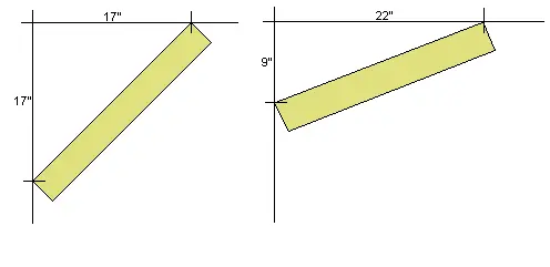

There are a few reasons, that i know of, why corners are good.
1. bass builds up between corners
2. the corner allows a large air-gap behind the panel(upto around 17" with a 2' panel)
So angling it differently it still helps with the bass building up between corners, and increases the air-gap on 1 side and decreases on the other.
Depending on what angle the sound hits(although it's generally omnidirectional, but for simplicity)the thickness of the absorption+air gap can be more than a stardard 45degree angle(on one side).
I'll show you what i mean.

Yeah it should still have almost the same benefit.

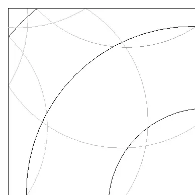

Actually, i think i might've worked it out. It this diagram correct showing a wave reflecting in a corner? So any absorption(thick enough) would reduce the reflections(grey).
The lines are just the peaks, the nulls are exactly the same, with everything in-between, all reverbing, mixing and creating havoc :D!

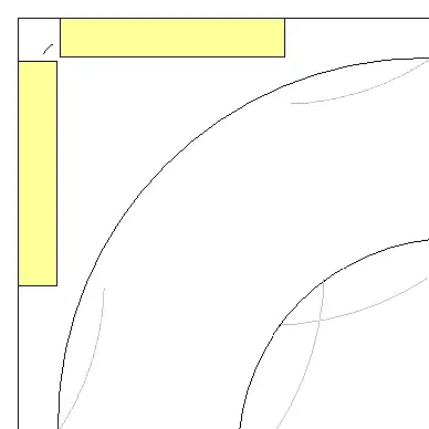

So with bass traps, it'd effectively be like this(obviously this is hugely simplistic)?
