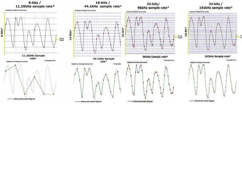

COOLCAT said:
I thought this was a pretty good visual on the bit thing, for those that don't have oscilliscopes hooked up to their Digital Ready headphones. :p
http://www.hwupgrade.it/articoli/1010/2.html
This visual representation is really really flawed.
First of all, with a 16bit signal, you have 15bits in either direction. One of the bits denotes + or -, the other 15 are the dynamic range. Same thing for all the bit depths, one bit for polarity, the rest for dynamic range.
The reconstructed files are also not a bunch of straight line connecting the dots. They are rounded just like the original signals (assuming the original signals are rounded).
These graphics were rendered by someone who doesn't know how digital audio works.
