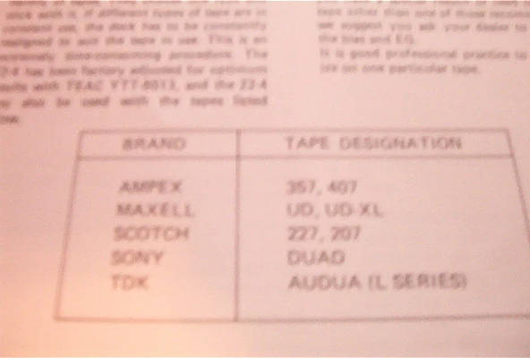

I'm looking at the manual and it says optimum results are with TEAC YTT-8013 and the following:
Maxell UD, UDXL, LN
Scotch 250, Master
Sony DUAD, SLH
TDK AUDUA, (L), T
Ampex 456
I guess that's why I had some confusion. The mechanical specs indicate 1 mil tape. Before posts got deleted, I got kind of barked at for not using the search button, but clearly there seems to be a discrepancy somewhere.
Are you sure you have the 22 series manual cause I have both the 22-2 maual and the 22-4 manual and they both say 407 tape.
456 is a 1.5 mil tape and biased at 250. Both machines manuals say they do not recommend 1.5 mil tape for the 22-4 or 22-2
Here is a pic of the manual I am using.
Maxell UD, UDXL, LN
Scotch 250, Master
Sony DUAD, SLH
TDK AUDUA, (L), T
Ampex 456
TEAC YTT-8013 was the in-house designation for a playback alignment tape used at the Montebello CA facility.
If the machine was set up in the 456 ball park, using 406 or similar tape would have you over biased enough that the recordings would come back on the dull side with a noticeable lack of headroom.
Conversely, if set up for 406/407 and their ilk but using 456-ish stuff, you'd be under biased enough to come back a bit bright with a bit more headroom at your disposal.

My manual says TEAC 22-4. I'll try to post a picture later on. I bought the manual separate from the machine which definitely says Tascam 22-4.
The Picture you posted looks like my 22-2 manual. The TEAC 22-4 manual looks slightly different.
I just thought of that before you posted. The 22 was a teac with the first models and that could be where the confusion comes in.
So is your recorder a teac or a tascam? I know the two machines look the same but just maybe there are some differences in the two.

Ok I did a little checking here and got the Teac/tascam manual out for the 22-4. I would have got it out sooner but I forgot I had it.
It says the ytt-8013 is a blank tape and if that tape is not available for alignment you may use a Maxell ud instead.
Now when you step up to the 34 they recomend Teac ytt-8063 .
