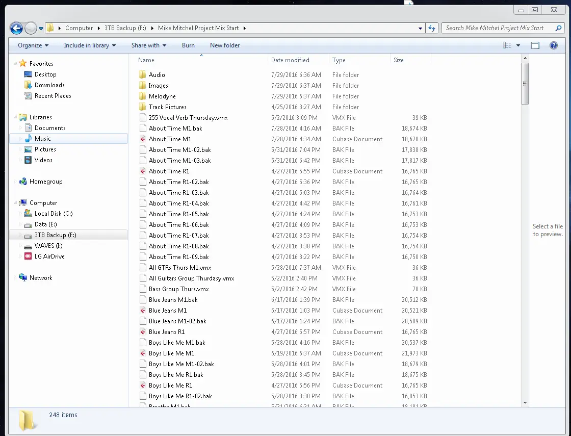

File management. This can be a tough thing to explain.
Your files for a project 'should' always be in one single folder that includes 'Audio' and 'Images' files. As well as the .cpr files. If the 'Audio' folder is not in there, then it is being saved to another location that you have not identified for the project. It happens when not paying attention. Been there done that. Newer versions of Cubase will also have a 'Track Pictures' folder and others like 'Melodyne' included in the same main folder if you are using them. The most important is to have ALL of the 'Audio/Images' files in the folder you are working with. If not you are the only one guessing where they are saved. Easy to lose.
Say I open a new project and forget to designate a folder location. It will be saved to the last opened one. So that means that my new project may be saving audio files to a completely un-related project. If I delete or move that old project folder, then Cubase will not be able to find the files for the new one.
So, for the future, when you open a new Cubase project, always check the box 'Prompt for project location'. This will save you much pain later. By default, it goes to 'Cubase Projects' on your 'C' drive. Not a good thing in my past experience...
For now since it seems you have not organized so well, open the project you are working on that you have files all opening. Edit>Back up Project>Set Project Folder in 'New Folder' location. This will save all of the necessary files so that you do not lose your project files or info. Keep close record of that and save to another drive if you have that ability. A project folder with the name of the project is absolutely imperative to keeping your work organized!
Now, know that once you open a project in Cubase 8 and save, it will not open in SX anymore. Make sure to keep them separate. You can have two of the same projects saved in different versions of Cubase. Just make sure you do not save in a newer version and delete the previous. Best to have two hard drives to keep them totally separate entities. Main important thing is to have all of your data for each project organized in one folder separate from ones in other versions of Cubase. Do not stray from that or you will have yourself a big pain in the ass...
I hope this made sense and helped. I screwed some projects up badly in the past. That is why I am trying to help here. Some find these things obvious. It took me countless hours to understand why and fixing my f-ups...
Should look like this. This is a 28 song project I am working on. All audio is in this folder. Saved to 3 hard drives just in case. But the idea is that everything is in one place and organized.
