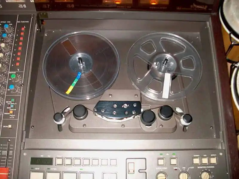

The corectadjustment is:
,... the centers of the Left and Right Tension Rollers should intersect on a plane that's even with the bottoms of the Idler and Tach roller,... (not the tops!)
You gotta forgive me for that error! Big difference!
This is the picture of the 388's servo's in balance during actual tape motion. This one's running spot-on!:eek:;)
