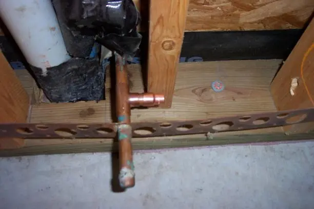

OK. The more I think about this, the more I realize I'm going to have to use 3/8" pipe.
I have to tee into 1/2" pipe.
Then reduce to 3/8".
That's simple enough to do with pipe fittings, but to try and do that with tubing fittings is going to result in one of those... "plumber's nightmares". You know.... where you end up with a bunch of different fittings....
Here's a pic of my own private little hell.
:D

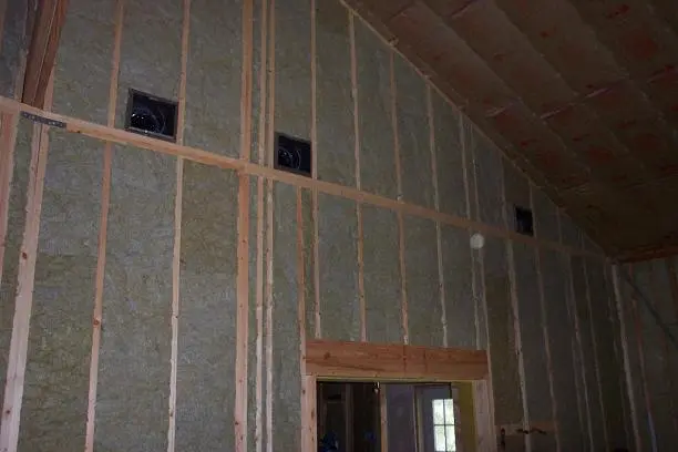

I've been rockwool-ing like a mad-man.
A little bit left to do in the bathroom, and I'll be done with that nasty stuff!

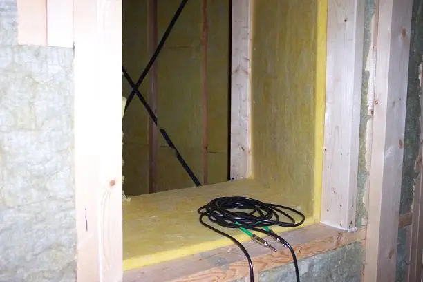

I do have the windows all blocked in.
This is the Vocal Booth window....
:D
(Thanks)

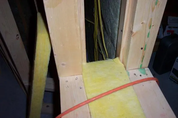

And here's the Control Room Window, all blocked in with 703.
That of course, will get covered with cloth. The 703 "sticks up" 1/2" so that when I put in the window seal, it'll all be flush.
In order to keep the 703 from just falling through, in between the walls, I had to install these 1x2 backing strips on the inside of the walls.
I'm not sure exactly how I'm going to secure the 703 to the backing strips. :confused:
Especially the top of the windows.
I'm not sure if adhesive would work, and I don't want any kind of nail or fastener showing through the fabric..... I dunno. I figure something out.
