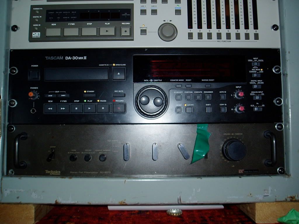

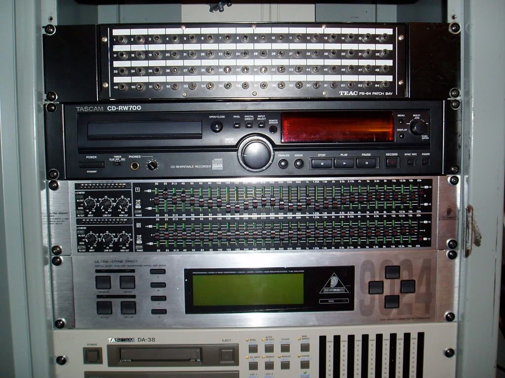

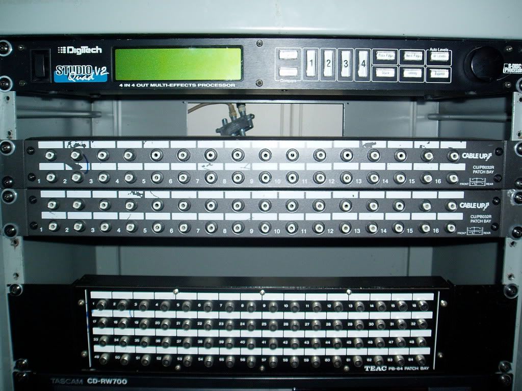

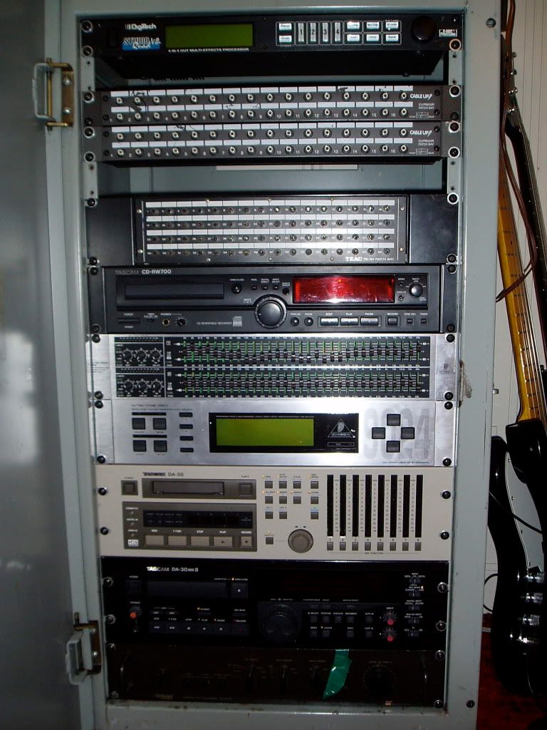

- Digitech Studio V2 Quad effects processor
- 3 RCA patch bays
- Tascam CD-RW700
- Behringer Ultra Graph Pro EQ

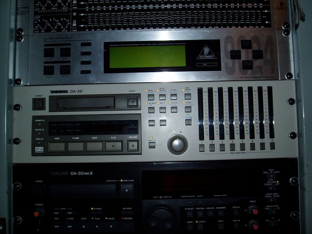

- Behringer Ultra-Dyne Pro model DSP-9024 (I have no idea what this is)
- Tascam DA-38
- Tascam DA-30 MKII DAT recorder
- a Technics Stereo Flat Pre-amp SU-9070
- a huge box of cables and snakes
- a big steel console box (that's what they're all in)
(Note: I do realize that this is not a full set and that I will need to purchase a few things in addition to whatever might be worth keeping in this list...)

The CDRW700 makes a nice player but the converters suck (S-U-C-K). Everything else is fairly old and useless (except maybe the patch bays).
The DA30's are usually going for around $15-25 if they're in decent working order and the DA38's are about the same -- Maybe $50 if it's in really nice shape.

I cut my studio teeth recording to a pair of DA-38s and mixing to a DA-30. You can do good work with that stuff if it's functioning properly. It's a good way to learn about the process. You will need a mixing board, preferably one aimed at the small studio market. A Mackie 1604 VLZ or Alesis Studio 32 would be appropriate. Avoid the original Mackie CR1604.
The Behringer analog eq is not really something I'd want to use, but in a pinch I suppose it could be better than nothing. Or not. If someone offers you any amount of money for it, take it.
The 9024 is old but useful. It's a digital EQ that can save settings to internal memory, but probably better suited to live use than studio. Keep it around.
The Digitech effects unit will do a lot of stuff, but I hear they're a pain to navigate. Keep it and learn to deal. Maybe add another effects unit down the road. You can find them cheap.
