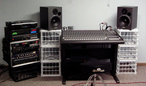

PS I'm going to attempt to post a pic in case anyone is interested...it's not that I think anyone would be, I'm just excited to have so much new stuff!
Cool setup.
