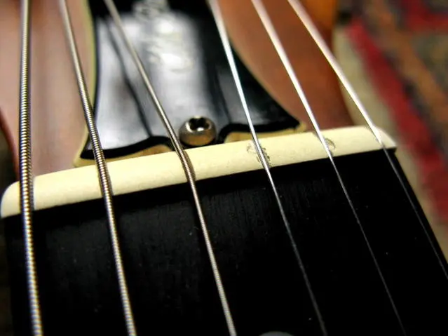

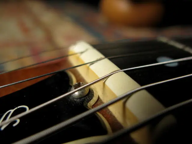

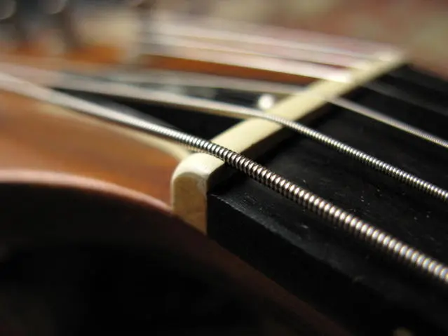

I had considered getting a new nut, but it's a rather expensive fix to do in a shop and I'm not sure I trust myself to get it right. Here's a couple pictures of the nut. The bridge, by the way, is brand-spankin' new, but I first noticed the noise with the old bridge.

Hrm, looking at the chips in the nut around the G and B strings, you'd probably want to replace that, anyway.
