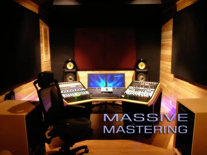

Did you see the new room? Just finished it Monday (Thanks, Farview and intern for coming over to take over as I slowly lost my mind throughout the day)... http://www.massivemastering.com/html/photos.html
I'll attach a photo below if I can figure this crazy thing out...

Anyway - Let's see if I can get that picture thing to work... Whatever happened to the IMG tags...

gorgeous John, I envy you.
Acoustically...what did you do, if you don't mind my asking? More specifically behind the walls, floor and ceiling. I can see all the bass traps.

21 of them - 18 2'x4', 2 3-ish'x4' and one 35"x78" (covers the entire door).
Smoooooth in the lows... Freakishly smooth.
Otherwise - The attached wall is pretty cool... 6" header/footer, two staggered sets of 2x4 studs, 9" of heavy insulation lightly compacted into the 6" gap, then covered (both sides) with 1-1/2" of drywall, plus the cedar on the inside. There are two exterior walls that were slightly "beefed up" for transmission, but nowhere near the extent of the main attached wall. The rear wall goes into a "foyer" of sorts - Basic, doubled drywall on one side and insulated. I wanted that one to pass a little more low end than the rest. There were a few "irregularities" added -- a slight angle to one side wall, a bow in the rear, and two slight pitches in the ceiling to avoid any flutter echo.
The walls are completely covered in cedar planks, every plank is Liquid-Nailed front to back, top to bottom and brad nailed.
The (wood laminate) floor is floating over concrete slab except for the front 4' of the room where the speakers are - The slab comes right up to the subfloor there. The speakers are de-de-de-de-decoupled from the room. From the bottom up - There's the concrete (then the floor) then granite slabs, then "ConeCoasters" (from SoundAnchors) then spikes, then the SoundAnchors stands, then the speakers. I think the only way I could decouple them more would be with some sort of anti-gravity unit.
The gear is on a dedicated circuit, the dimmers on another. Computers & security are on UPS systems, main power goes through a Monster Pro 3500 (Instant gear on, delayed amplifier - Instant amp off, delayed gear). Shaved a few dB off the noise floor from the old room. And it's nice and even... Always had about a dB more on the right in the old room... Never could figure it out...
