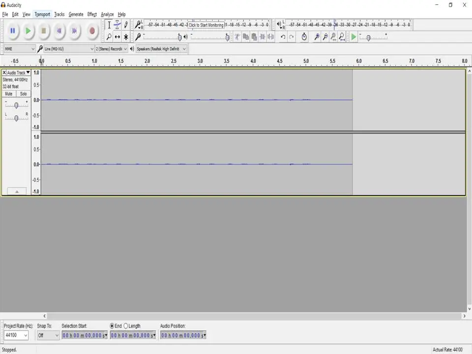

I'm using a Yamaha MG10XU for podcasting, and the quality of the audio is great, unfortunately it's very quiet. I'm attaching a screenshot of what it looks like on audacity. I saw another thread addressing this problem and it didn't help. I'm connecting it to my computer through USB. One thing to note is that the peak section on the mixer is not lighting up at all, but I'm not sure if it's supposed to given that it's connected via USB. A couple things that I've checked.
-Both the mixer and the microphones are appearing in Windows 10 and turned up
-The level for both the microphone and stereo level for the entire mixer are at the 12 o clock position
-Gain and Comp are both at the 12 o clock position as well
-The USB button on the mixer is pressed
-I've pressed HPF 80Hz underneath the first XLR plugin
I'm still learning about podcasting and how to use mixers, so I apologize in advance for any confusion.
Thanks!

- What are you using for a microphone? Is phantom power on if needed?
- Why have you set things at 12o'clock? Read the manual on how to set the channel Gain for the mic for starters, particularly since you're not lighting the Peak light occasionally.
- Make sure a pad switch isn't enabled.
- The manual suggests a setting for the channel Level knob.
- Unless you have monitors connected the Stereo Level knob can be set at zero, although it does affect the output metering if you should want to watch that.
- What are trying to achieve with the compressor? If you're not sure, leave it at zero until you know why you want to use it.
- Generally when recording to software your recordings may be low, both in output audio and the waveforms displayed. This can be adjusted after the recording is done to get higher levels.
Audacity can not use ASIO drivers which it appears are available and can be installed for this mixer. Audacity will use your Window 10 audio system drivers for the mixers USB and may have setting in that that need to be tweaked.

I'm using the Behringer XM1800S Dynamic Cardioid mics, and they do not require phantom power.
I have the gain set and 12 because even with it turned all the way up or all the way down, there isn't a real difference in the loudness.
That's odd. Maybe if the loudness didn't change it may be the compressor that was holding the level at a somewhat same level once it reached the knee point. Not 100% sure of this, but a thought.
How do I tweak the Windows 10 system drivers?
As for both the mics and the mixer appearing in Windows 10, I can't explain it either. I did think it was odd.
Where the mics and mixer showed in Win10 there may be level adjustment and perhaps something else that may affect levels. Not much more that can be 'tweaked' other than that.
