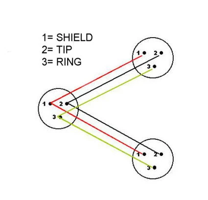

Insert Diagram for TRS to 2x XLR?
Hello,
I am trying to make a TRS to 2 XLR (male and female) for my dbx gates that only have xlr ins and outs. Should I just use the hot pin on the xlr or what? I'm confused. If anybody has a diagram, that would help me out.
Thanks!
TRS to 2 XLR
Hello,
Thanks!
Is this what you are after refer to attached picture..
