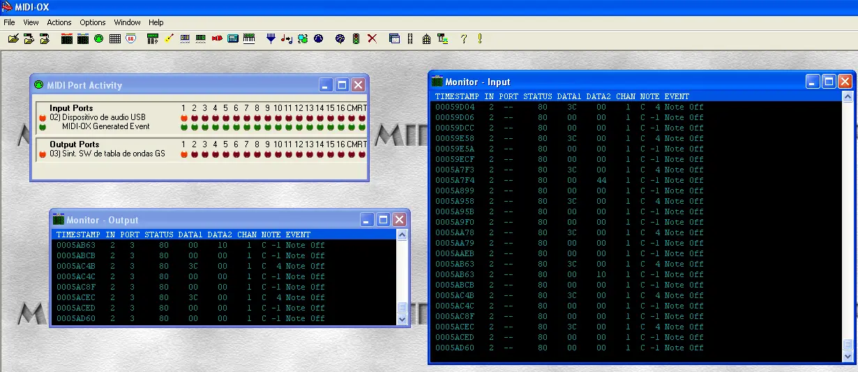

I have problems to get my midi keyboard to work... I'm using a MIDI to USB cable
I tried to get it to work on win7 but failed... Now I'm trying on Win XP...
When I check the activity data on the program MIDI-OX I get this output...
As shown on the image every time I press a key in my keboard I get a "Note Off" EVENT
I don't know whats going on...
If someone could help me it would be really appreciated...
Thanks in advanced
Sorry for my bad English...
What keyboard are you using? It could be something in keyboards settings.
Are the midi cables connected correctly? Have you tried swapping in and out cable?
You sure about the cable? There is another 5 pin cable that looks exactly like a midi cable but it is wired differently. If you are using the wrong cable then your midi data would end up scrambled like this, because the pin wiring is in a different order.
