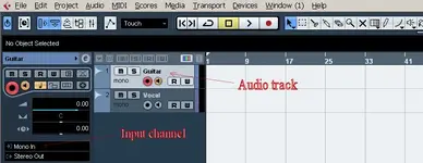

I am trying to record vocals in Cubase 4. I have one track which contains a wave music file. Track 2 is my blank track. Cubase records the audio track 1 into my newly recorded audio track 2. Why? I don't want that in there. How can I make sure that it isn't mixed into the new track?

You must setup your inputs in 'VST Connections'. Then change the source input for each track via the 'Inspector' window on the left pane of a selected track. Arm the track you want to record to, and click the 'Monitor' icon to hear the input.

In the 'Inspector' window at the left of the main project window, look for a symbol that looks kinda like this: >] SEE ATTACHMENT
This is where you select the bus you created in VST Connections. You will change this on each track that is using a different input channel from your interface.
