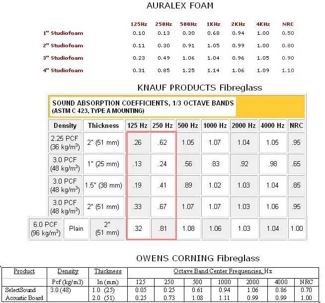

Check out the difference between foam and fibreglass relative to thickness and absorption.
cheers
John

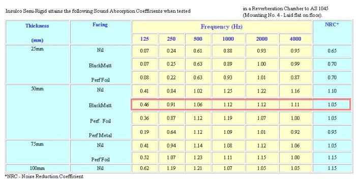

BTW the stuff I used in Left Bank is Insulco - an aussie product. I've highlighted the 2" I used.

Ok then, it looks better on paper. Is this the standard fiberglass insulation you speak of or some kind of panel? What about cost? Thickness? How does one use it, nail it right to the wall? Make a frame for it?
I've heard of using the fiberglass but never really looked into it all.
Info please. Links, maybe.
Peace!

Ok, cool... lets take that black Owens Corning stuff for instance... how do I use it as opposed to using some auralex foam? How does it compare pricewise? How much is a sheet, I'm guessing it is4x8 foot?
Thanks...
