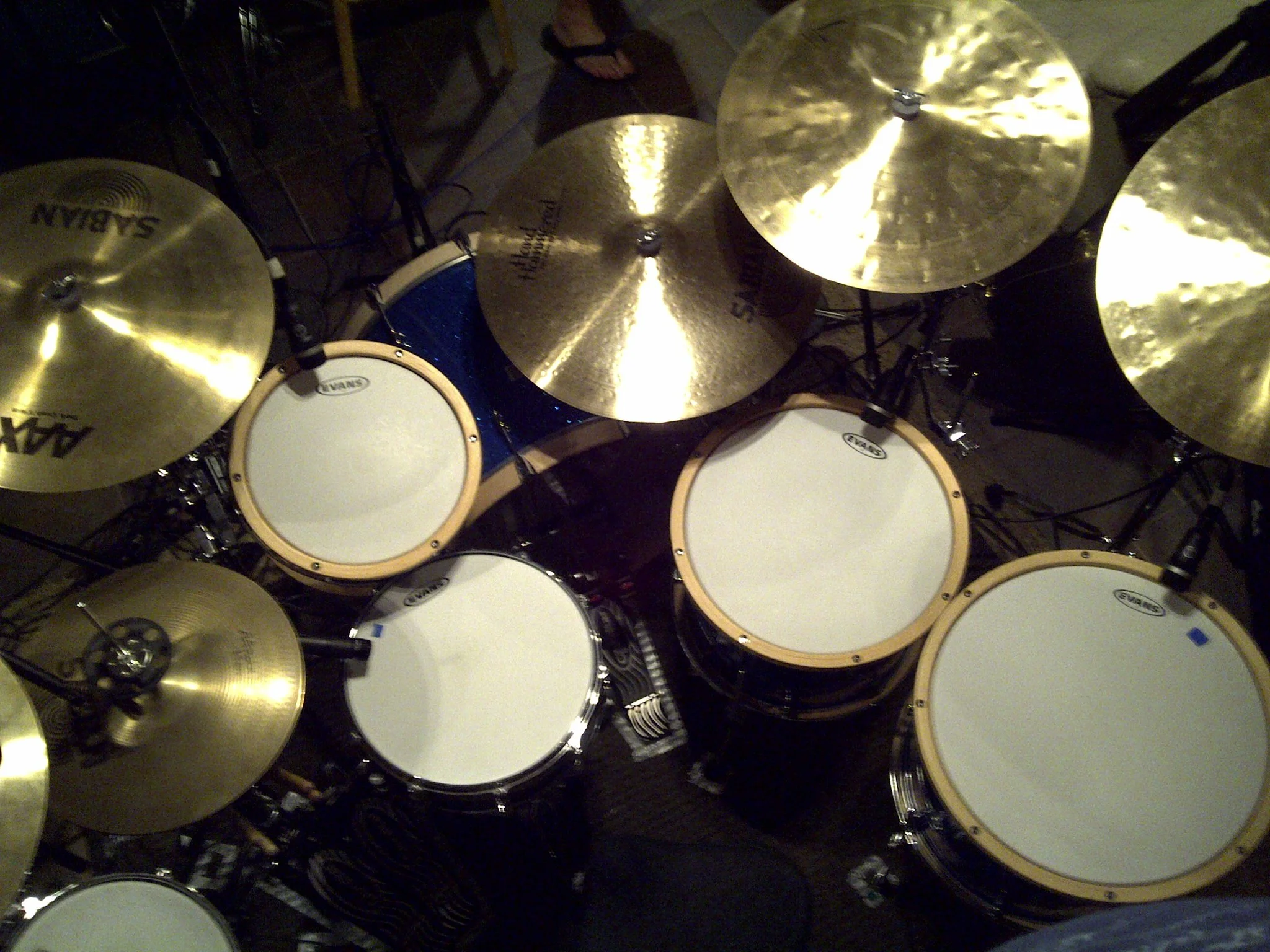

Here's a pic of my kit from bird's eye view. If I were to bring the mics in closer (you can't see em), I'd be getting wayyy too much hi tom and ride in the OH's (proximity) and barely no 2nd floor tom or china, etc. I want everything in the OH's to be equally as loud as I'm hitting it, and not have certain elements too quiet only because I didn't capture them well in the mics. 1.webp
Everything you're saying makes sense. But you might have mis-understood my point. Or maybe I mis-understood yours. I was questioning why someone would place their mics wide, and then narrow the stereo field in mixing. I was also wondering how something would supposedly sound "un-natural" if the mics weren't placed "un-naturally" wide to begin with.
