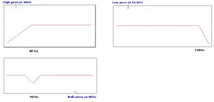

A highpass filter usually refers to an EQ (equalizer).
It's when you set it at a certain frequency, say, 40 Hz, and let all frequencies above 40Hz "pass through" or go uneffected, but all frequencies below 40Hz get dropped down in level (a slope).

I haven't used Audition in awhile. But I think that's just a bell curve (a V shaped dip in the frequencies).
A high pass will remove all frequencies below the set frequency.
I attached a very (poor) example I drew in MSPaint. Hope it clears it up a little.
