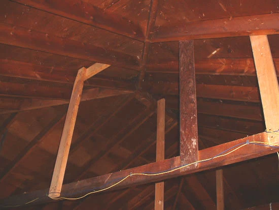

Ok folks, quick question:
What do I do with my roof? I was planning on sealing the underside with a layer of drywall. There's 2*6 rafters to attach to.
The question I have, is it really necessary to insulate the cavities?
I'm planning on having separate cielings (insulated) for my internal rooms.
Here's a pic
I'd rum battens at 90 degrees to the trusses and drywall that if you are going to put a new ceiling below. But you must put insulation above the drywall to stop the cavity above resonating.
