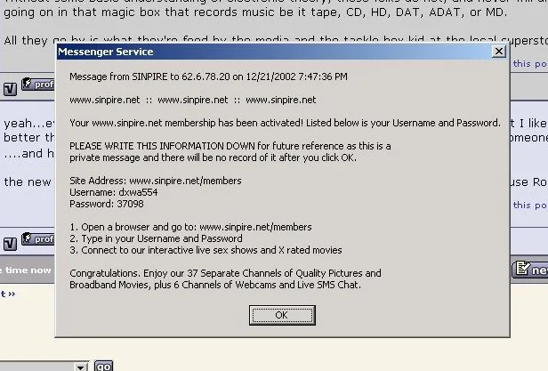

what the HELL IS THIS!!!
  • Thread starter Thread starter kristian
kristian
kristian
This popped on my screen while i was surfing homerecording.com, but it doesn't haven anything to do with the website. I'm hoping for some help with the computer savvy out there. I use mozilla, but i know this sort of windows popup happens with MSIM, which also, i don't use nor is it installed. This is my parent's computer, so something fishy is happening. what the hell is going on#?~~~!!"£

Emeric - MSIM is definitely not installed. I installed only AIM for my parents a year ago so they can leave messages when I'm at school in the states.
M.Brane - This is defeinitely not a "popup window". This is something different, its something built into windows so you wouldn't be able to have it pop up on your mac. Its some vulnerability which I thought was only possible on PCs with MSIM on them. But clearly not.
Yea it isn't so much a probem that its on my parents computer because I don't want them to see it, it is because they don't install things and/or go to porn sites. Have someone found another clever way to use some vulnerable MS protocol?
OH YEA
The IP address on that message was definitely mine at the time. They have a dialup connection but i used http://dslreports.com/whois to get the IP at the time and it was the same as they had on the popup. So that makes me curious as to how they got that info.

That is actually a fairly new exploit of the Windows Messenger Service. If you have Win2K or Windows XP (or even *gasp* NT!), you have a bunch of little services running. The Messenger service is designed to let administrators on your LAN can send the users messages (such as "LAN is going down in 10 minutes, please log-off")
Someone (someone very evil!) wrote a program which is capable of sending these alerts to 1000s and 1000s of (internet) users at once. They first appeared back in August (I think) and the first spam I got was for a University Diploma (no thanks!). I was perplexed because when I got the alert it was in the middle of the night, I had no browsers open, I had ZoneAlarm running, and ZoneAlarm had not logged anything.
The easiest fix is to disable the Messenger service from the Services applet. Do a search on Google using "Windows Messenger Spam" and you'll find out all the details.
I don't believe this has anything to do with Spyware.
Thanks eveyone, I was going for a little more of the technical explanation like gordone hit right on. It was bugging me becuase those alerts came out of MSIM at first, now i guess they have busted into Messenger Service somehow. I have win2k, and that service is running, so im going to turn it off.
