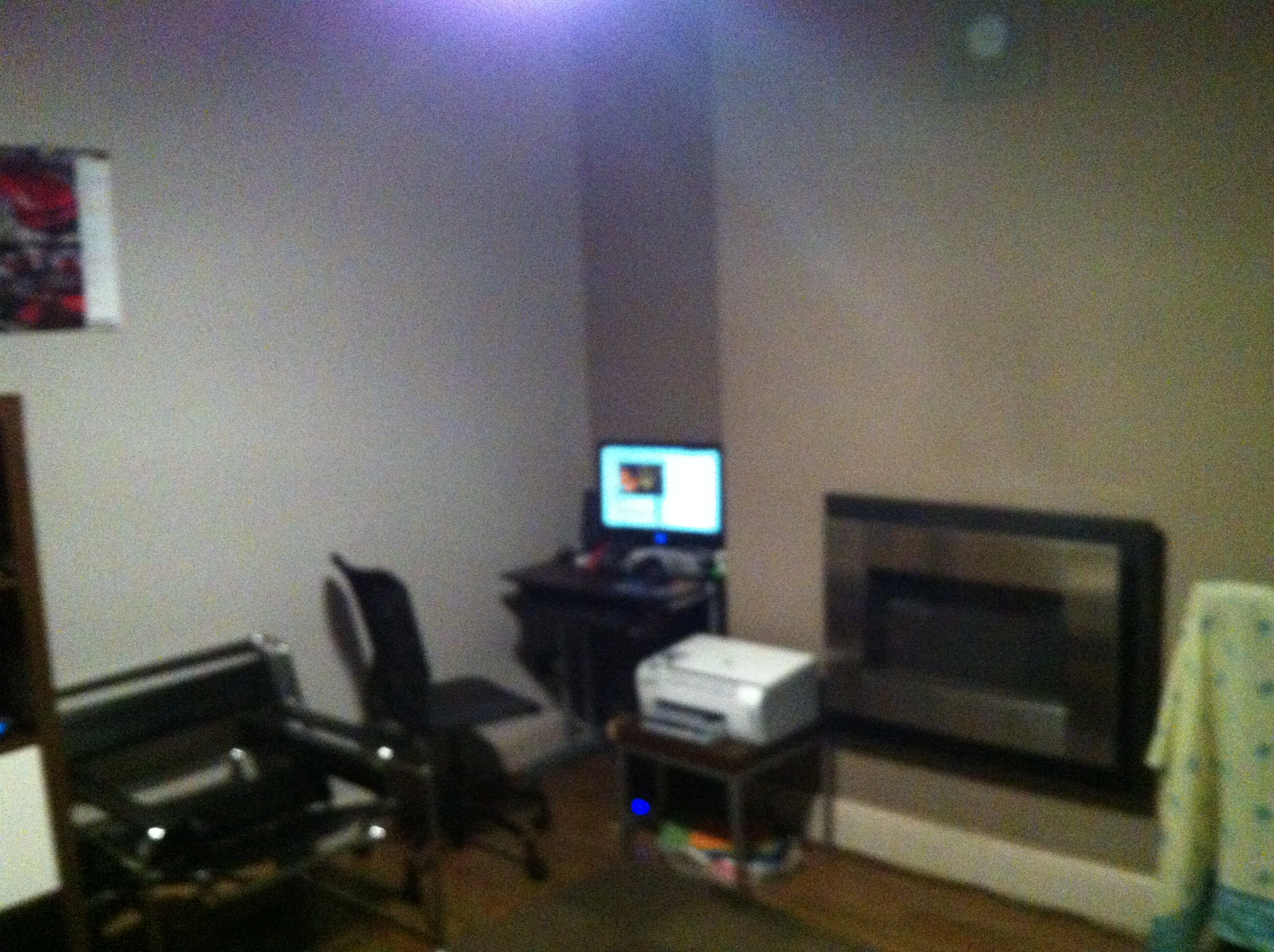

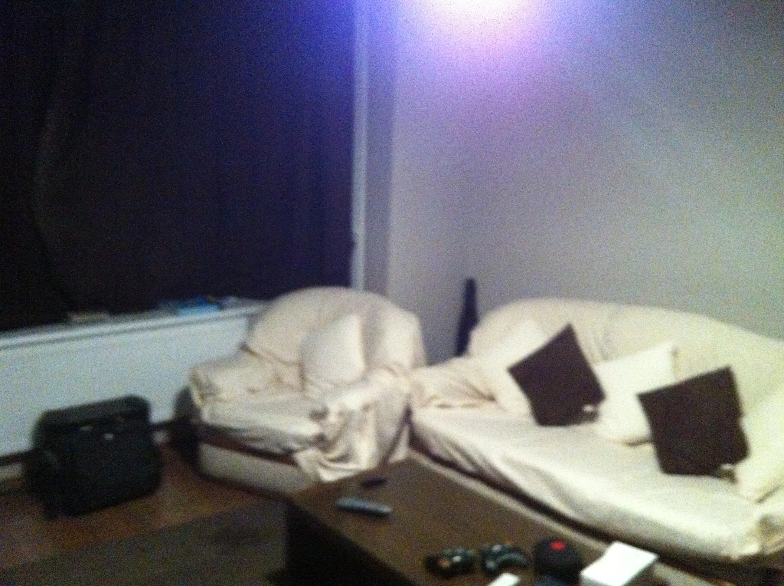

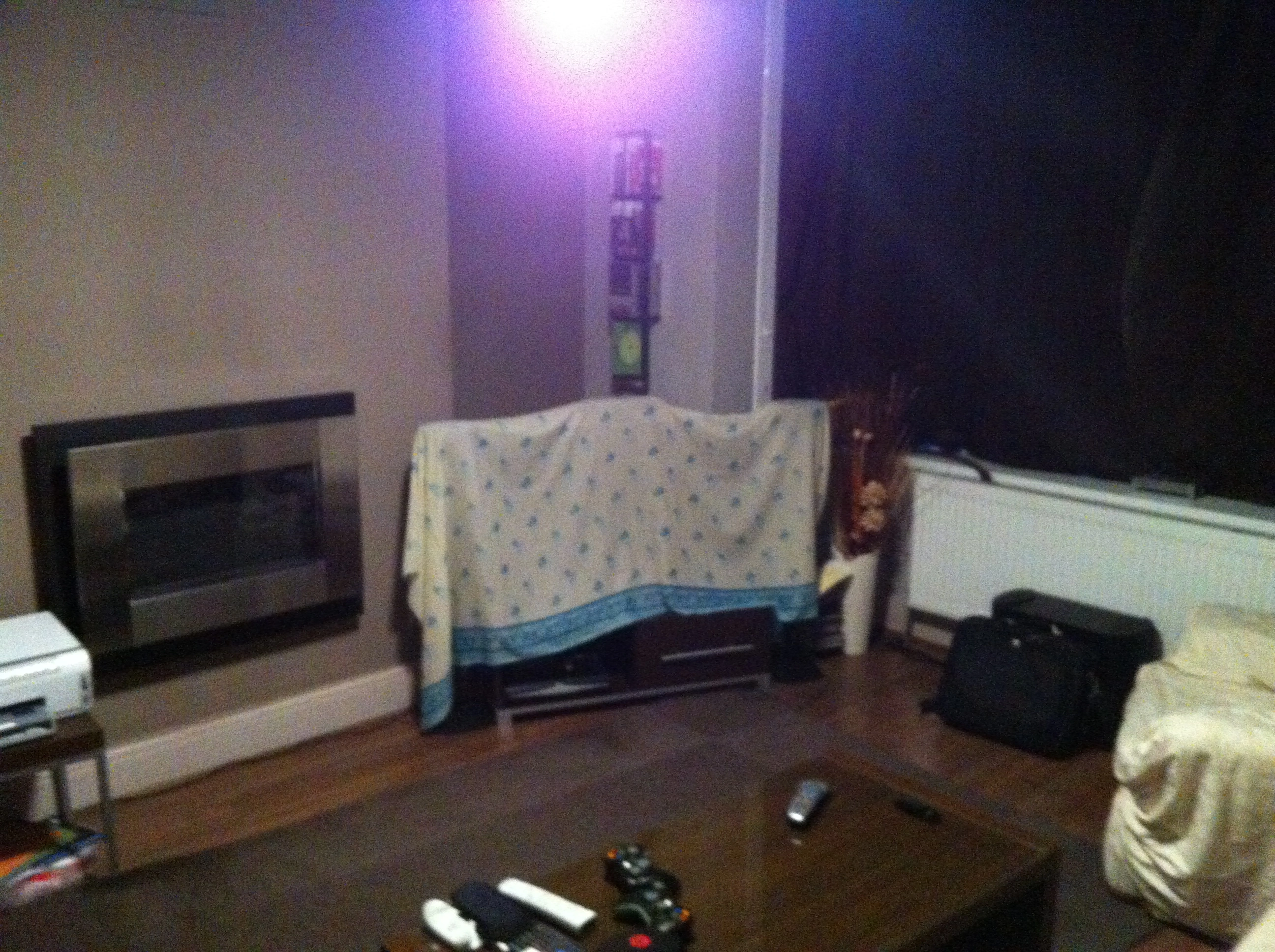

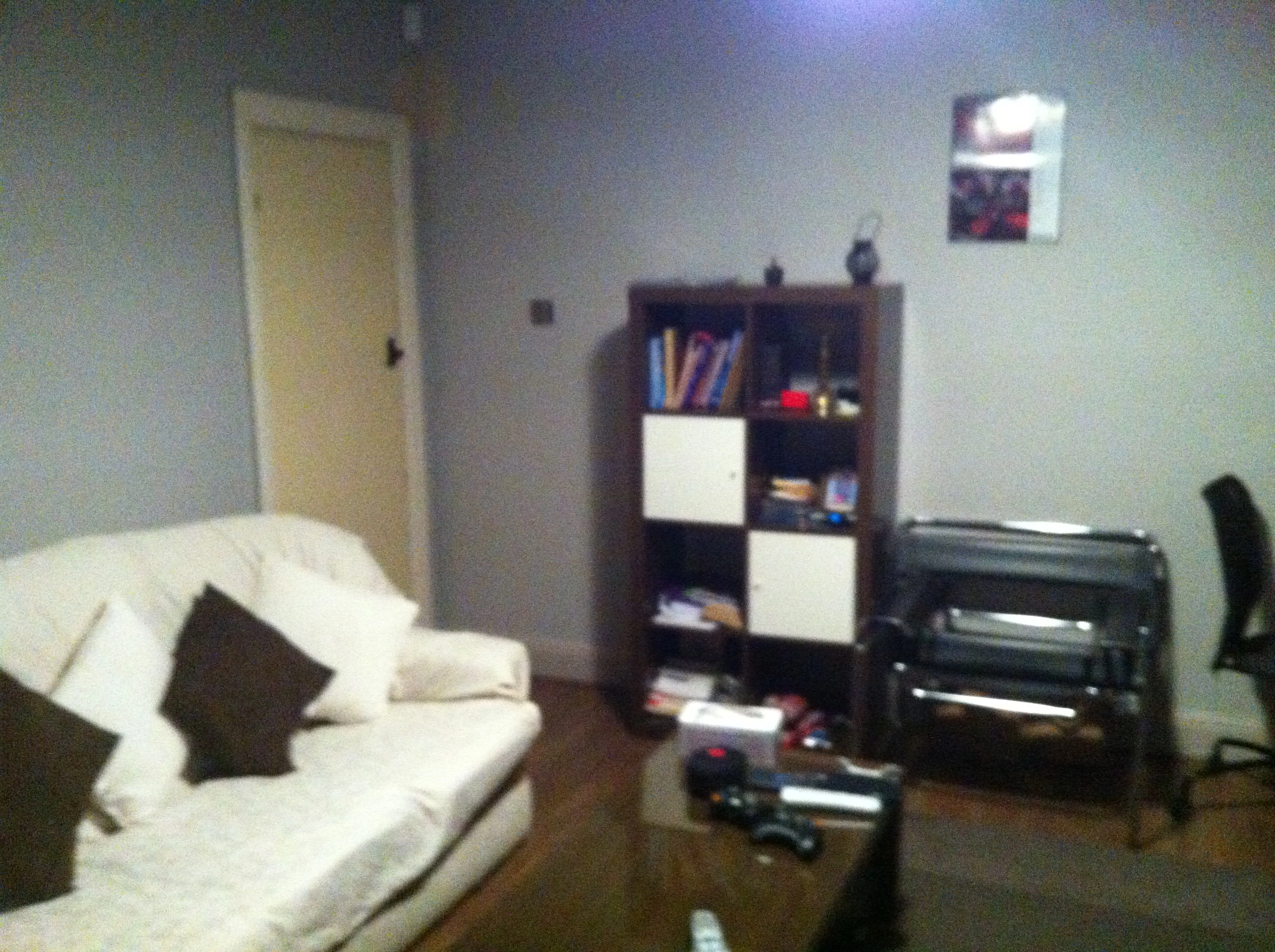

here are some photos from all corners of the room. I will be using this room for my recordings. I haven't tested anything yet, but by the looks of it, do you think the room is an environment that you can record in, obviously with room treatment as well. Im going to be getting studio monitors, would I need certain treatment for this too?
Is this room square? Hard to tell the dimensions from the pix. My approach would be to setup your desk centered in front of the window (must get out of that corner!), a couple feet out from it. Those little niches to each side may be a double f**k as far as needing more bass traps. The door in the corner will be a bit of an issue, but there are ways to work with that too.
Are you handy with a few tools? You would be best/cheapest building your own bass traps and absorbers if you are. If you are planning to move to the attic, build corner bass traps that can be portable, at height that will fit upstairs. Just lean them in the room corners for now.
Where do you live? Rockwool is the most efficient/cost effective material to use in the states, as long as there is a supplier nearby. Shipping can kill a budget if not found local. I believe I only spent $600 for 13 4" thick 2'x4' absorbers, and 2 4" thick 2'X8' corner traps. And a 25'X13' ceiling full of the 4" rockwool in my drum room. I found the material for quite cheap, and the frames are made of 1"x2" pine.
