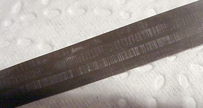

Thinking about it, it's not quite such an apples-to-oranges comparison as it first seems.
DSD uses pulse-density modulation rather than usual PCM, hence it records a single bit at a stupid frequency and somehow stores the level in the time domain rather than directly recording the level as a number.
The result is something like this:
(source: https://en.wikipedia.org/wiki/Pulse...a/File:Pulse-density_modulation_2_periods.gif )
Now. If we take a piece of analogue tape and coat it with magnetic developer, we end up with something eerily similar:
(source: http://www.audio-restoration.com/tapetrk1.jpg )
