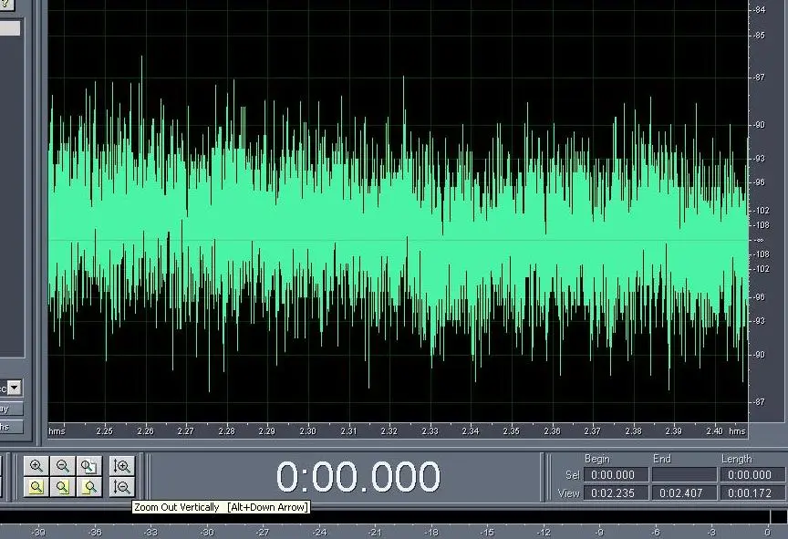

Al chuck...i just hit zoom and couple of times to make it look like that. mine, on first glance, was just the same way (really rectangled out in some places!)...
see if yours does the same, zoom in horizontally a bit.

I looked at the noise floor (zoomed in on blank recordings in CoolEdit like shackrock did) on both the front and rear line outs and they looked almost exactly the same. Centered at around -78dB (weird... should have been centered at -infinity), peaking around -63dB. Although there must have been some other difference not immediately noticeable as the rears were SO much more stable than the fronts in setting up the RMAA test (no warnings about crosstalk at all)

You guys have a lot of DC offset issues. That is why the waveform isn't exactly centered around 0. That causes premature distortion and robs you of headroom and dynamic range.
The noise floor will also be different in 16 or 24bit if the card is up to snuff and actually has a better SNR (signal to noise ratio) than 16bits allows. The maximum SNR for 16bit is 96db and for 24bit it is 144db.
...so are you saying that mine does NOT have dc offset issue, since it is centered at -invinity? i mean, to be frank i dont know what that means even...haha

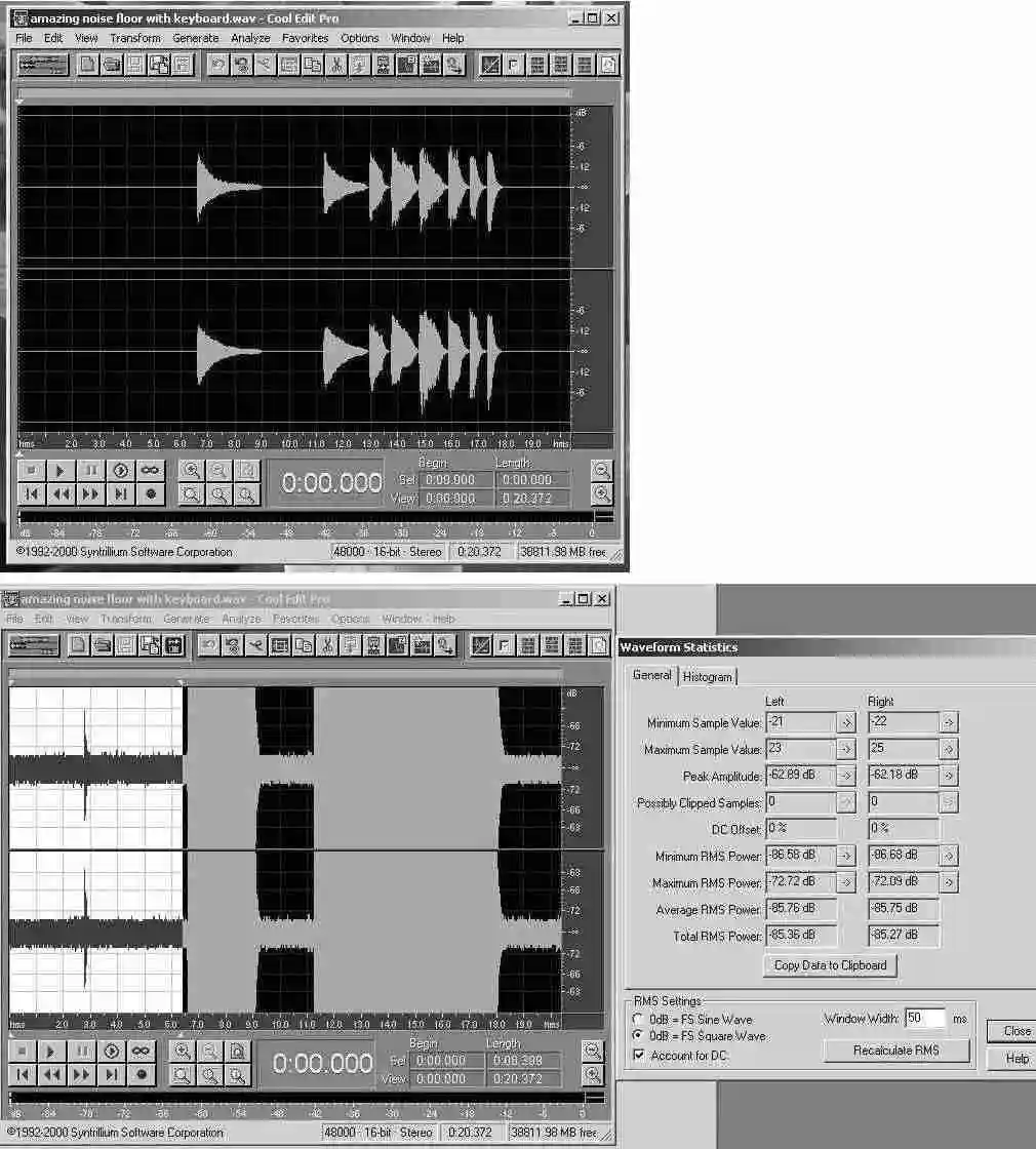

Now onto the noise issue, mainly by lowering the Line In recording level slider in the Windows Mixer to just below half, I was able to significantly lower my noise floor. And now, for some strange reason, the 60Hz hum is completely gone. I'm using the Tape Outs from the mixer, the Rear Line Outs on the soundcard are fired back into channels 7/8 on the mixer, then muted and sent to Alt 3/4, which is sent to the headphones instead of the main mix.
I honestly cannot say what got rid of the 60 cycle hum. Tonight I think I'm going to take a bunch of digital photos of all the wires and hookups and such, just so that if it comes back I'll have something to reference.
Below is a composite screen shot showing the waveform in CoolEdit. I recorded a signal from my keyboard that peaked around -3dB (first pic) then zoomed in to make the noise floor visible and ran the Statistics function to show the Total RMS Power at a mere -85dB.
(sorry about the crap pic quality... had to lower the jpg compression to get it under 100k)
This sounds and looks really good to me. The only reason I'm posting this is to maybe help point out some of the abilities of my set up (SBLive, Behringer 1204Pro mixer, Hosa cables), which is pretty low-end, to some other users out there who might be thinking of upgrading some of their components. I'll be moving to a better sound card, mostly for frequency response. The SBLive seems to strip alot of the life out of the sound. I don't imagine it would make much of a difference on my noise floor though, as its already pretty good. As long as that mystery 60 cycle hum doesn't return, I'm perfectly happy, at the moment, with this mixer and these cables.
