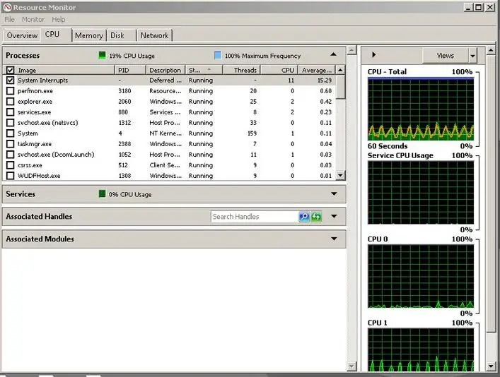

I can't figure out what is causing this. No programs running at startup. Firewall off. System is, to the best of my knowledge, setup for audio performance.
I am afraid to start messing with windows in services.msc or msconfig without knowing what I am doing. :eek:
Repetitive CPU usage spikes up to 30% is killing my audio performance.
Any ideas?

What processors are you running, and are you doing primarily MIDI, or Audio?
Can you post your settings for latency and such?
Thanks for reply sir!
AMD AthlonX2. Audio. Which settings should I post (from where)?

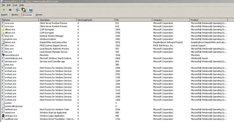

Yeah - but you can get that without putting the program in gear - it generates that list on startup. If you click the little green arrow, and wait for about 2 minutes, it SHOULD aggregate data on your system.

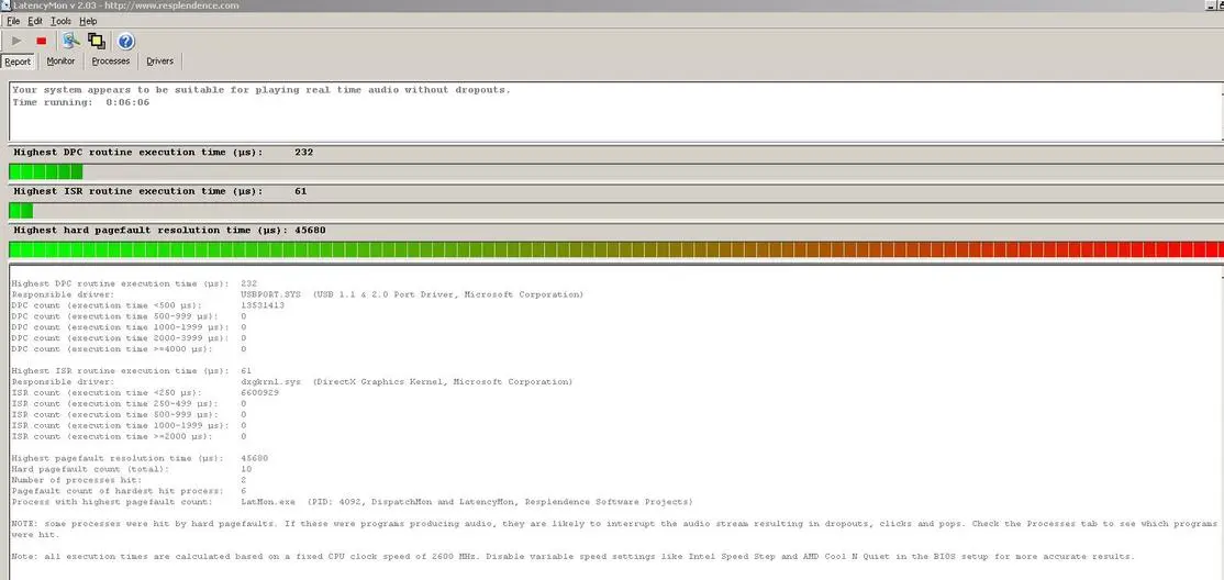

It says everything is fine but when I record with lower buffer settings on the Tascam in Cubase, I can see those little spikes hitting the VST Performance meter overload light. I cant be sure but they seem to happen in the same pattern as I see in the Task manager performance meter with nothing running. That is why I query as to what might be causing this. Or is it just the way it is?
I am not the most computer literate idiot in the village obviously.
You should look at the report screen and the monitor tab - after you've run it a little.
Check the drivers tab too. Between all of them - you'll see after a couple of minutes of looking what processes are spiking the system.
Also - if you haven't already - turn drive indexing off.
(My computer > right-click on the drive > properties > uncheck "index this drive for faster searching"
Dood! Disabling SuperFetch just cut that CPU usage peaks to 15%! You rule!!!!!
