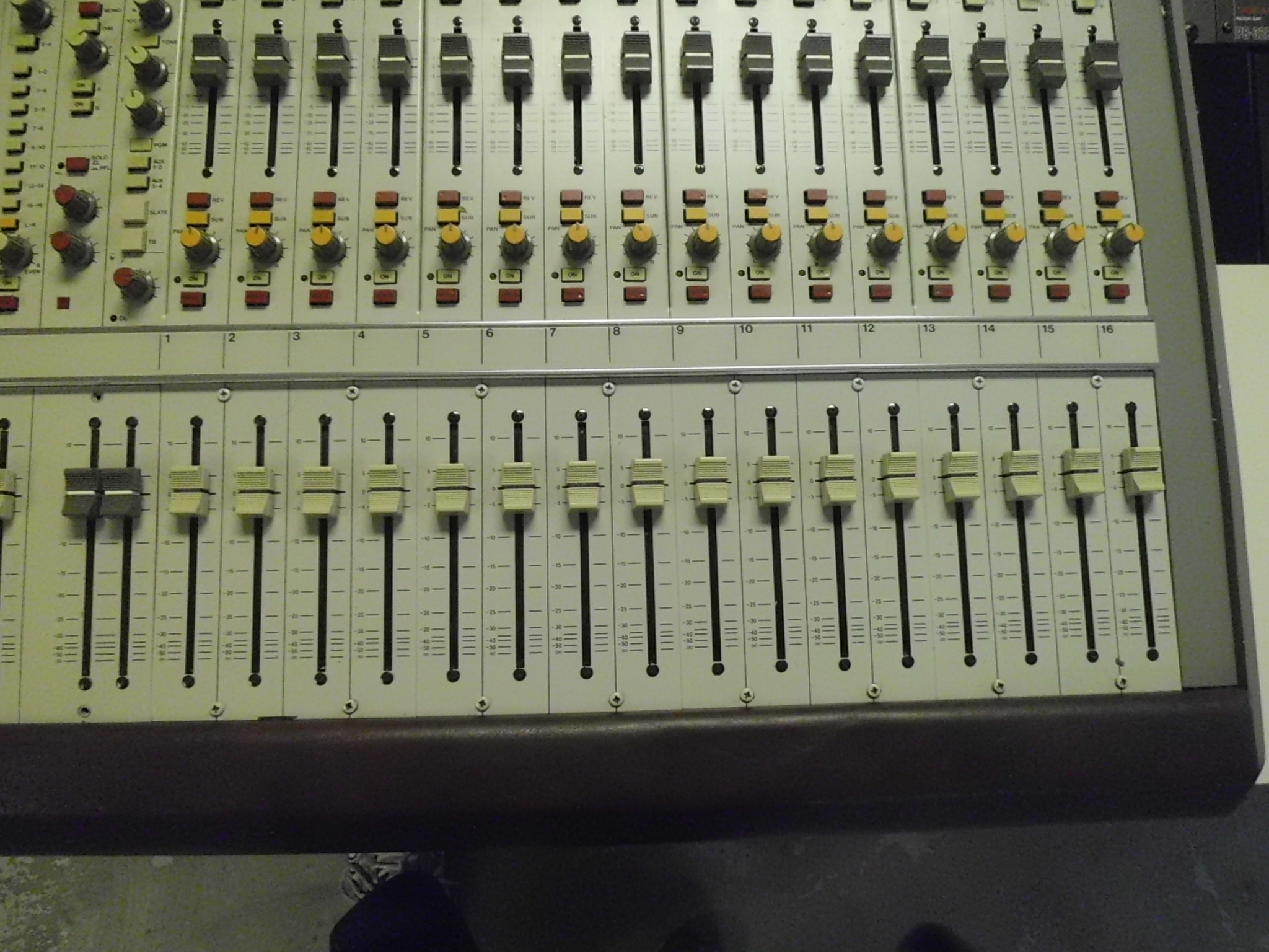

I don't know what's typical, but on my board. The 16 buss's show-up in the separate monitor section. And can be switched between PGM and Monitor. Each having a separate fader. Too... each has the same Eq. as the input channels. So they can also be used as additional input channels. Typically, these 16 monitor modules are used to monitor the output from the MTR. I think!:confused:
I probably just made it clear as mud for you!:D

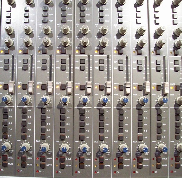

The monitor buss is what you listen to when you're tracking. Inline consoles have a tape machine return buss so you can have a monitor mix that is independent from the levels you are actually sending the multitrack through the channel path. For mixing, most pro consoles will allow you to switch to a mix mode so that the multitrack outputs are fed to the channel inputs. In this case you mix to the "mix buss" out to the 2track.
This ^^^^^ An inline monitor bus will have small faders like the pic below, or sometimes rotary pots.
