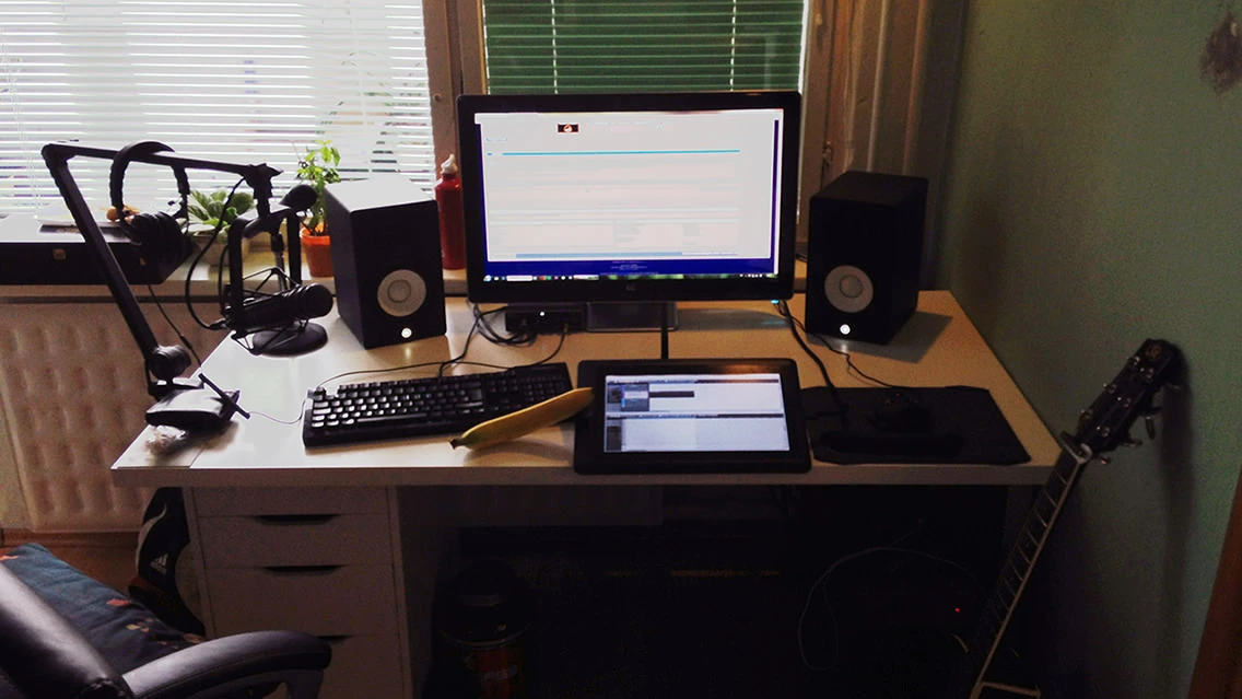

Hey guys, just a quick update.
I did some research and bought these Yamaha HS5 monitors. I also did a few recordings and found out I need a pop filter.
Right now, I'm having a bit of a trouble with low end, so after a bit of a research I'm looking for a way to move my whole table to the center of this room (there's a radiator, and my cables don't stretch that far).
I'll probably do some padding on the wall to the right, and some on the windows in front of the computer.

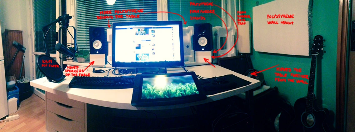

Well, here's some update.
I moved the whole table to be more in the middle of the room. My space is very very limited, this is the best I could do.
I don't know about the polystyrene, have no clue about sound absorbing properties. I just had a lot of that stuff lying around, so I used the available resources.
It seems to respond better than nothing to a set of advanced tests (loud clapping and full volume music).
With my crafting skills, I brought the tweeters exactly to ear height. I moved the speakers further - off the table and closer to the glass behind them. I measured the equilateral triangle to my ears also.
I didn't know what's a lesser of two evils, speakers on the table - or speakers close to a surface. I still don't know, but the playback seems about fine both ways. Didn't get to buying a sound level meter yet.
There's not much that can be done in this room - it's basically a kitchen. I'll get to the floor plan in a bit.

Progress Jozo, progress.
Unfortunately expanded polystyrene has the sound absorbing properties of brick, i.e. none to speak of!..BUT! You done good getting the speakers off the table and elevating them and in getting the table further into the room.
I think your instincts are right from where you have placed the panels they now need to be made of the right stuff. If you don't have the funds for commercial materials there are plenty of sites that show how to roll your own.
A SPL meter is not vital but very useful. The idea is to monitor at consistent, standard levels, not as your guts guide you song to song! Once you are set up, the received wisdom is to listen to as much commercial music, of your chosen genre, as possible to get a feel of how the balance translates with your own monitor/room combination.

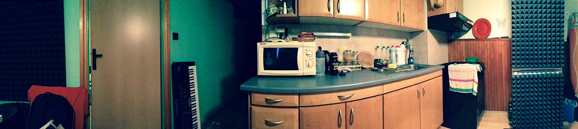

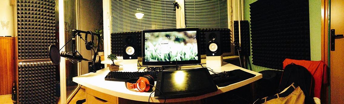

Here's an update.
I'm positively surprised by the difference in sound this makes. Knowing this room I'd never guess.
I had to put those speakers back on the table, with the foam they just won't fit. I'll address this issue asap.
And I'm even more surprised by the good looks. :) I'm really proud of the fridge.
I still have some foam left for the door to the right and some surfaces behind me, but I ran out of velcro.
Any thoughts?

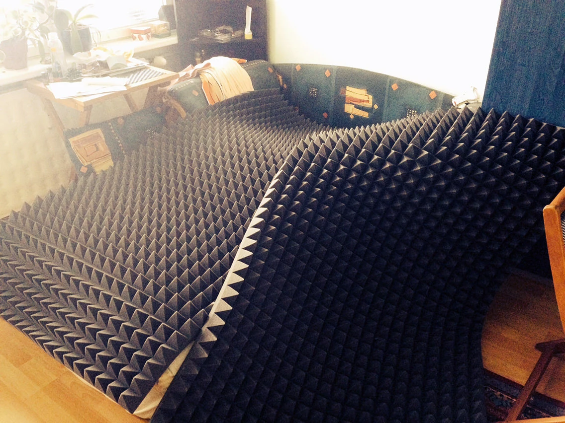

This is behind me:
Hey thanks Dave, that's a great idea. I wouldn't think of mobile panels, I'll definitely see what I can do.
