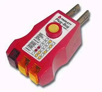

IMO isolating the room’s AC is the place to start. If that’s too ambitious for some, the first step is to make sure the outlets are wired correctly (right polarity) so the chassis ground actually works for devices with two-prong plugs. You’ll often see Hot and Neutral wires reversed.
Start by getting an inexpensive GFCI tester (see pic) to make sure you have adequate ground and your Hot and Neutral are wired correctly. You can find them at Radio Shack and hardware stores... maybe even Wal-Mart in the lighting dept.
