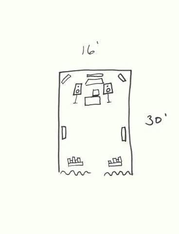

Anyways, I have 6 acoustic panels on the way along with the itch to build some diffusers and really dig in and design a space. I've done a lot of reading on the subject, but I have a few questions specific to the space I'll be working with.
1. I have attached a diagram, hopefully (albeit poorly drawn) with my idea. I only have the six panels right now (designated by the rectangle looking shapes - two in the corners, two above my workstation, and two on the first reflection point). Not my most intelligent question - but is this right?
2. Now the issues that I think may arise...the wavy line at the bottom of the drawing is a proposed "curtain" - there is no wall there, it opens up into a more rectangular space with the next wall about 12 feet away. There are already weights and camping supplies taking up space, and cannot be moved. So...is a curtain a fair idea - or better to leave it open? I know that theater curtains have been mentioned on the topic, but I'd probably just get something closer to a common curtain.
2a. The two skyline looking squares at the bottom (near the curtain) are diffusers. I'm not going to lie - I think they look badass, and would be fun to build. However, I want them to be functional (at least to a certain degree). Is this the best location for them? Is there a better location? I've read that it's best to keep them away from 1st reflection points, but I only have 2" rockboard, and the diffusers seem may receive some reflection from the panels.
3. Would panels/traps on the curtain side be a good idea? I know that all rooms are different, and those will have to come later, anyways, but just planning ahead.
4. Lastly, the ceiling is an issue. It's low - 9 feet - with a foot of flooring (joists 'n what not) where sound could bounce around. In addition, there's a heating duct running right down the middle. How much harm to the sound will it create, if any? Can it be covered with a cheaper material? And how bad/irrelevant is the ceiling?
I'm not going to cover the ceiling with drywall or anything over the top - other than the two initial panels over the workstation, and maybe a couple more panels in the future.
I'm not going to record that loud, mainly just country/bluegrass rock or whatever, and I don't have high expectations for my recordings. However, I am going to purchase basic budget equipment, and want to have as nice a space as possible to work with, and begin the learning how sound works (and how to control it to the best of my ability - no matter how low my budget).
Oh, the room has concrete walls and floor, exposed ceiling.
Thank you for any and all advice,
Daryl
