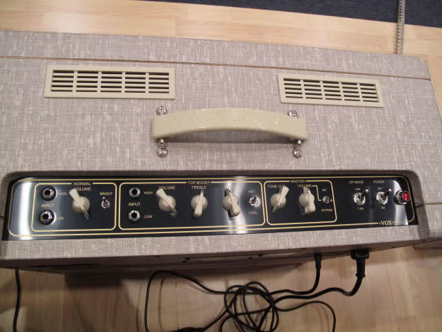

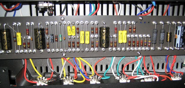

I've got an AC15HW1X, it's a Cadillac, birch ply cab, built like a tank.
I figured that as far as value goes, it is 80% to a botique amp for about 2/3 the cost.
And it should also hold its resell value well.
The wiring is done in Vietnam. and it is wired differently from a standard AC15.
Shots taken from the internets:
It can be switched to bybass the tone stack for the most part, and it can also be switched to bybass the MV altogether.
It really is an incredible sounding amp when pushed, only you can decide if it is worth the money.
