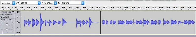

Hard to imagine anything but a defective mic behaving like that. Here's two clips (pasted together) in Audacity where I just recorded the same thing: my voice measuring about 88dB or so holding the phone while talking into the mic, then putting the mic on a stand so it's 1" in front of my guitar amp, where I'd set the volume so it would read about the same dB.
Recording was done with a Shure Beta 57a. I don't actually own an SM58 or SM57, though the latter's on my short list!

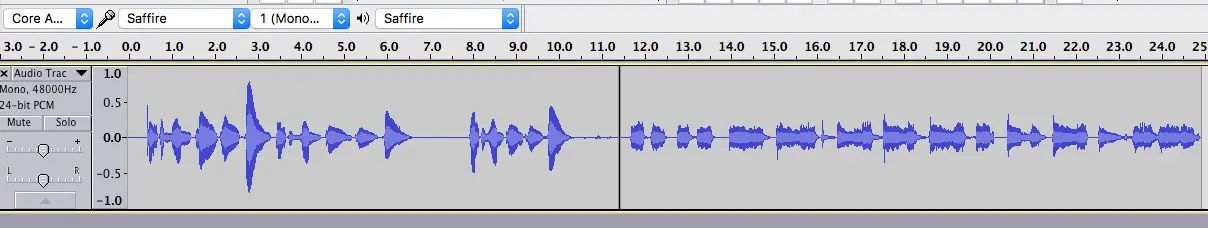

Well I bought a new XLR-cable and it seems to be working much better now!
(Picture from audacity of guitar recording zoomed in at the same level as the last picture: /hexkRJ
Also, the tracks in Logic shows more volume coming into the mic now)
