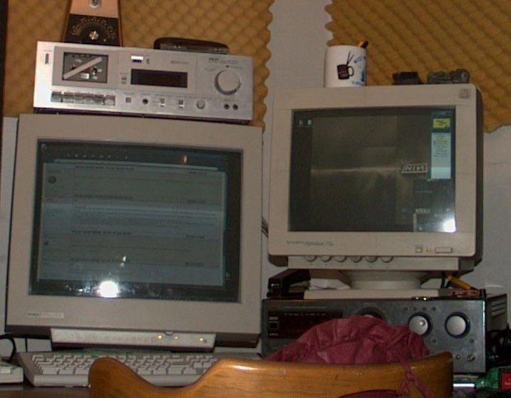

I run dual monitors, and I use a 8mb AGP and an ancient 4MB PCI card. If oyu do thigns besides recording (games, other things, which i'd think you do having a voodoo3) you have to get your better card as a PCI. Win98/95 and I think 2000 all use the PCI card as yoru primary. Sucks, but oh well, I like my 21" and 17" both runnign at once. Plus it freaks people out when they see the mouse jump over between monitors.
I don't know anything about overclocking, sorry.
Also don't know anything about the video card with 2 outs, but I do know that having 2 video cards works good. Windows immediately recognizes them and you just click the little "Extend My Windows Desktop Onto This Monitor" and baboom, big ass screen.
