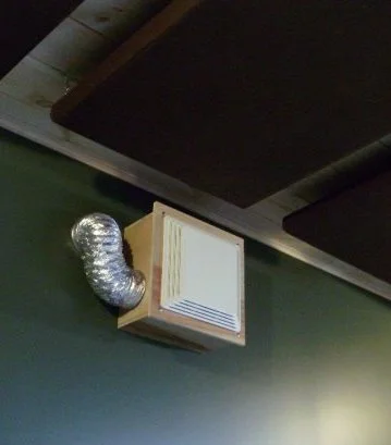

Heres mine...it's not in a vocal booth but its used in my live room to quickly clear the air in between takes as needed. Down and dirty $80 Home depot. I made the box out of 1/2" pre-finished birch ply. I recently painted the grill flat black with Krylon "plastics paint" it exhausts into my old furnace vent and up thru the chimney.

Scott - That looks like a bathroom fan. Is it and if so what is the sound rating on it?
Yes...It is a bathroom fan, it's a "NuTone" Exhaust fan actually, I think it's 1.5 Sones moving 80CFM's. It's quiet, and I definitely wont have it on when tracking or mixing, but it wouldn't be a problem if I was just rehearsing my band.

You should never use a chimney for ventilation purposes. There is the hazard of carbon monoxide poisoning from fumes backing up through the fan when it is not running.
I hope you DO NOT have a furnace or other combustible exhaust producing appliance currently utilizing that chimney. If you do then immediately remove that fan from the chimney and seal up the hole and use another means to vent it to the outside. You can cut a 4" dryer vent into the rim joist and vent it that way but really 80 CFM's is doing practically nothing for that space.

The chimney is not in use and the liner is brand spankin new. Our new furnace is Natural Gas and that unit has it's own intake and exhaust in another location in the house.
Also, the fan does a fine job, otherwise it wouldn't be there. The function I need is to exchange air from my not so smoke free studio, during break times. ;)
