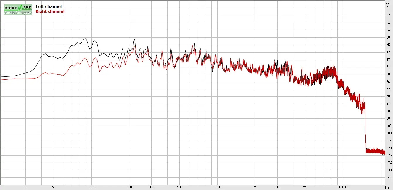

To inject a little experimental "skyence" here?
Attached is a spectrum of a clip from the YT vid the OP mentioned, a truly awful recording.
But you can see that most of the energy (first 30 secs or so) is around 100Hz, bit of a lower blip around 50Hz and a wee bump around 40Hz on the right hand channel.
The odd thing is that singer responsible for the bass notes is on the right but his sound comes out of my left can! The sound also does NOT move with him.
But, as I say, crap recording.
