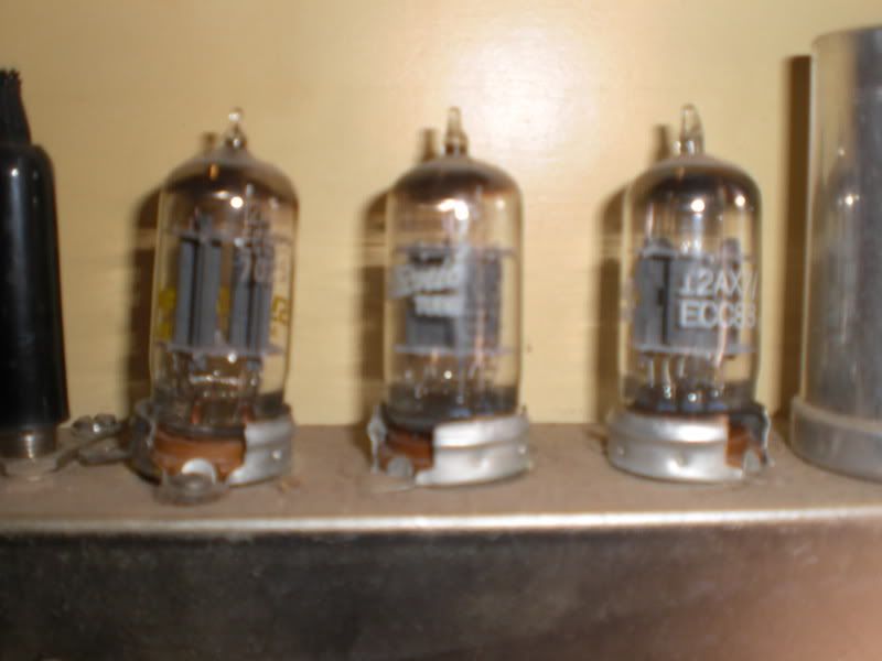

I've got a small assortment of old preamp tubes. It's fun to compare them against each other. The tubes in the picture are re-branded Amperex.
Sorry
I forget the picture
now, you must also do a fair comparison - play a few of your favorite settings, write them down, then play those same settings with same guitar, etc. with new tubes.
you must let us know what you hear :D (and more specifically what sort of tubes those are).
I'll most Definitely do that....Once I get my guitar working...if you look at my other thread, my amp is breaking...:(
Vintage tubes are my favorite form of recycling. What brand are they?

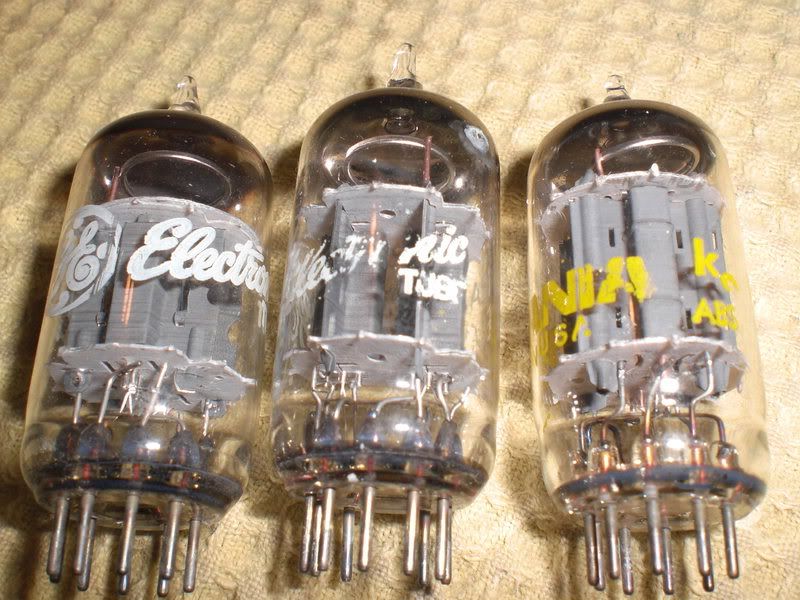

All these tubes from the organ (3 of them) are the same size and everything.

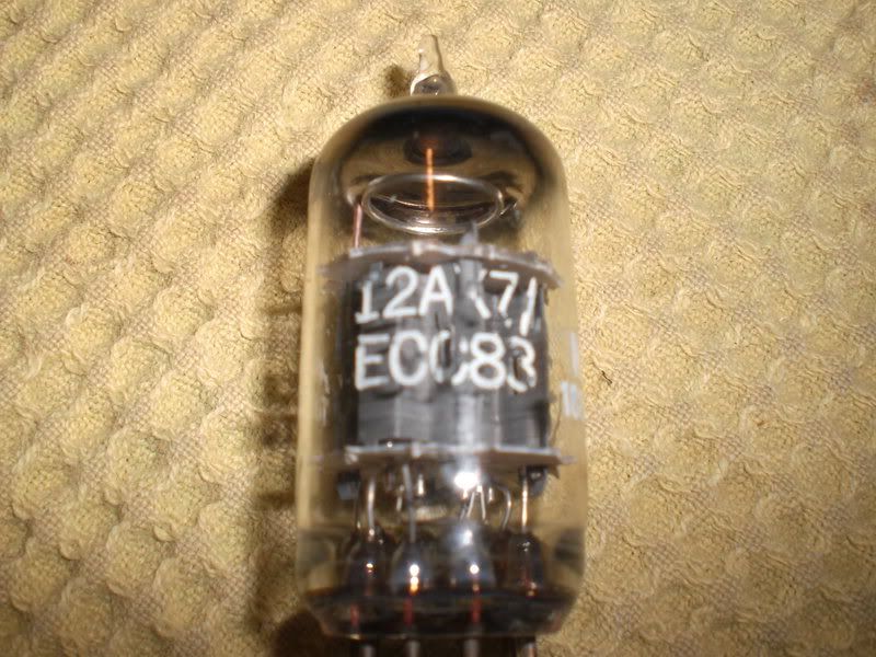

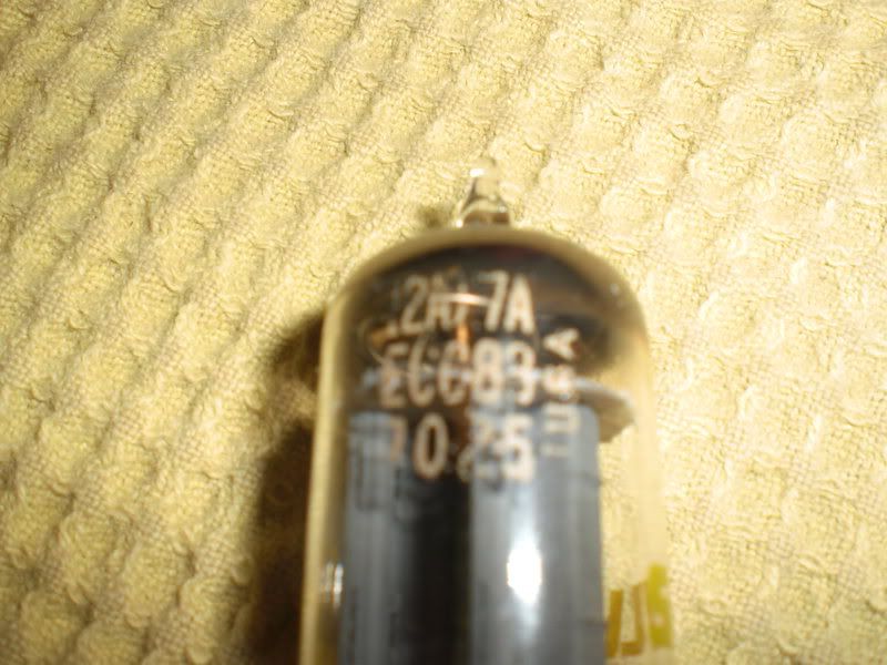

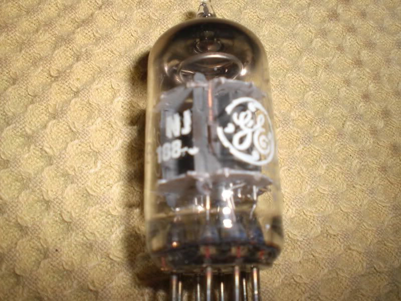

Only one actually has "12AX7A" on it. It is a General Electric tube. it also has ECC83 on it. And "NJ" with "188" below it.

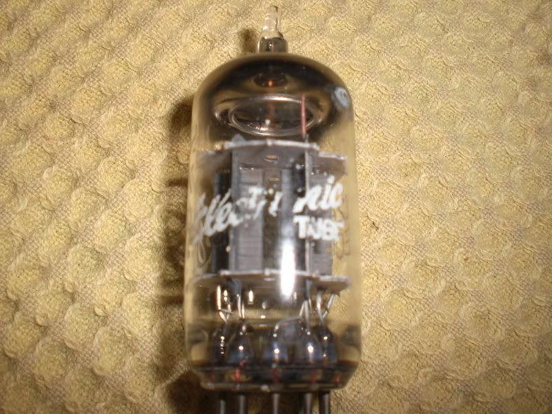

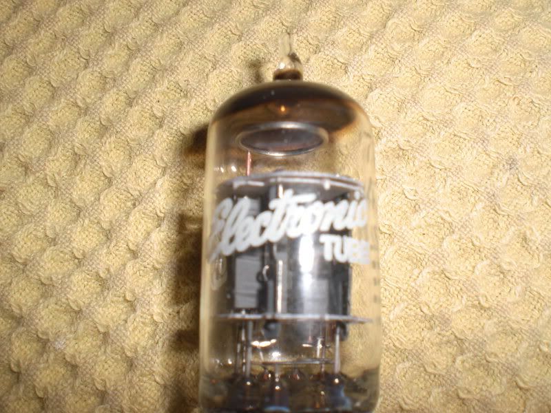

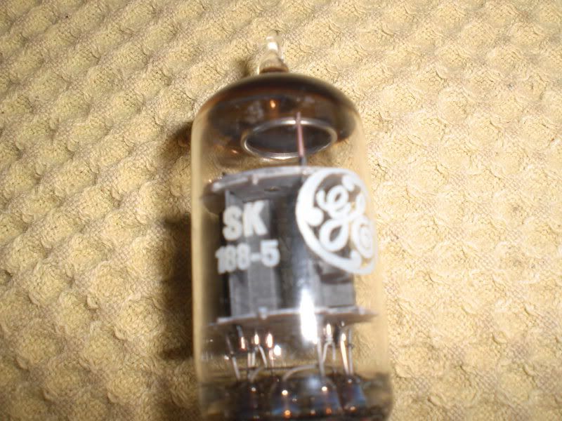

Next one...Also a General Electric "Electronic Tube" All it has is "SK" with "188-5" below it.

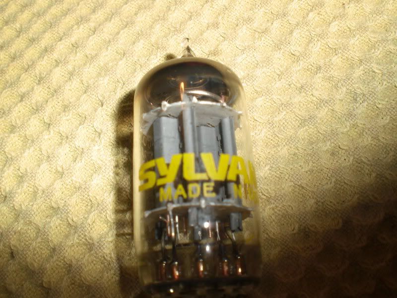

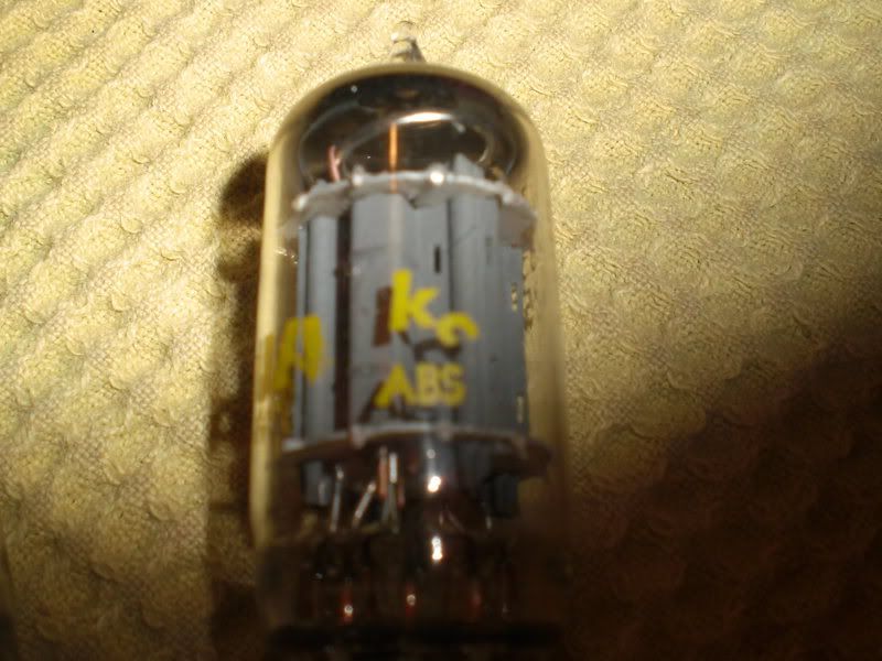

The last one is a Sylvania. "K?" (?=non legible letter/number of some sort) and under that is ABS. Now looking closer I see that this one also has "12AX7A" and below that it has "EC83" and blow that "7025" and then "USA" beside those.
So there's info on the tubes...the one without any indication of 12ax7...is that automatically a "12a_7" due to it's shape/size? thanks for all the help guys.
Look at the tubes very closely. The glass may be etched. Sometimes it's difficult to see. The unknown tube is just that. There are many tubes that will fit that socket that aren't compatible with a 12AX7. If you had a schematic for the organ you could identify it that way maybe. GE's are good, although not my first choice in a preamp I like them for a Phase Inverter. Sylvania 12AX7's are a rare, and beautiful thing. I've got one that sounds great. They're not very common. ECC83 is a different name for the same tube.

Here are some pics of the tubes. Like 10 pictures...But yeah. I couldn't find any etching on the "unknown" tube. There is no manual to the organ either.
Is there a way to put these pictures in a spoiler type deal? Or no? There are a bunch of them.
Let me know,and I'll edit this post. Otherwise...Here they are. (no organized order of any sort really.)
12ax7-ecc83-7025... all the same tube... 12ax7 is US... ecc83 is british/european... 7025 is military spec...
