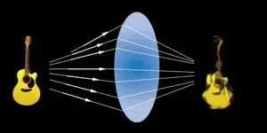

This article from Studio Reviews has me perplexed: http://www.studioreviews.com/pre.htm
The basic premise is that a quality preamp will make tracks more focused, and therefore easier to separate and place in a mix. The visual he provides is certainly compelling. And great professional mixes do tend to sound the way that visual looks.
But having never used a quality preamp myself, the notion that a great preamp makes sound more focused strikes me as ... silly. Frankly, I assumed the separation and placement in great commercial mixes was due to the engineer's skill with mic placement, EQ, and reverb. Other than pre's that obviously colour the sound (which seems to me the opposite of focus,) isn't a preamp just an element of gain staging?
If you've used a high-end preamp, do you agree with the article's premise? Can a great preamp by itself make a recording sound more focused?
I like his analogies and illustrations. What he says seems to make total sense on paper, but I don't have good enough ears or know enough to tell you if it's as defined as he makes it.

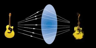

:D Whooo hooo-ey ! ! This is your guitar ... and this is your guitar on Dan Richards!

The funny thing about DOT's illistration on that paper is that it shows the quality preamp making a smaller footprint than the cheap pre. Now, I've never read a preamp ad or review touting how small it sounds. :D
Dan knows his stuff though, and the camera lense analogy certainly rings true for something like a Grace. I will always point out though, that many great photos have made good use of grainyness and deliberately shallow depth of field with resultant blurring. I want to have the equivalent of a Zeiss lense in my rack, but I would'nt want to record everything through it. Great focus isn't always what every track calls for, IMHO.

I don't know about all that stuff. Although the whole "focusing sounds" thing is pretty odd. I just think the way it was written ... and with the diagram of the clear guitar going through the evil window and coming out all warped and twisted like a funhouse mirror on the other end. Pure classic. :D
