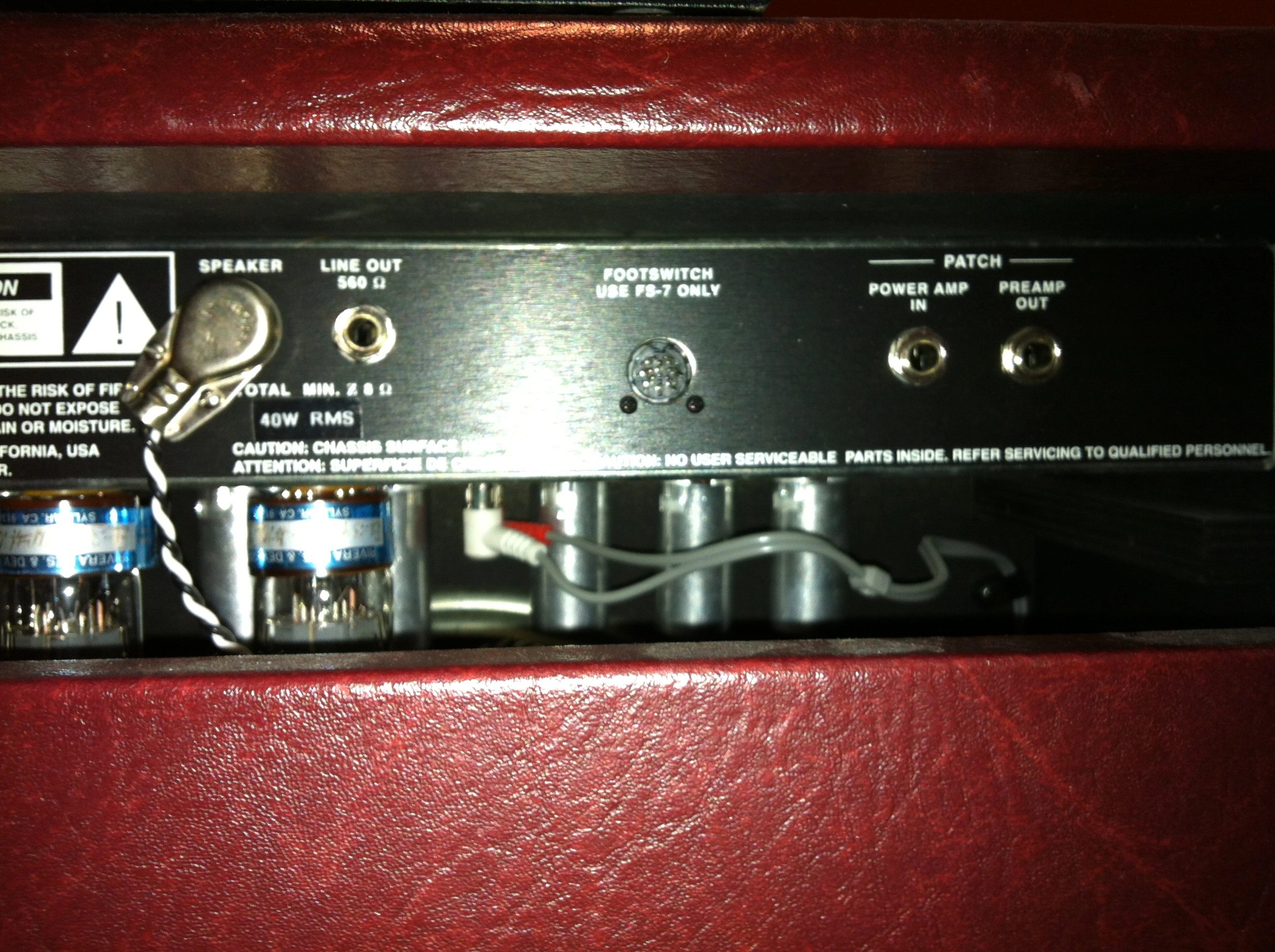

Picture of Pre-amp attached. Sorry it says 560 ohms. Its the output to the right of of the one with the cable going to the speakers.

Yep, that's a Line Out alright! You might check the manual though. Looks like that's probably an attenuated and speaker emulated (filtered) output from after the power amp - meant to make the direct output sound more like the mic'd cab. This might work, but for a microphone which is catching a signal already filtered by a guitar speaker, it might not be ideal. There is that hole over to the right which is just straight out of the preamp which might work better for what you're trying to accomplish.
Neither of those outputs will hurt your interface, which is why I say just try it. Like I said, if it sucks it sucks. Either way, you learn something, right?
