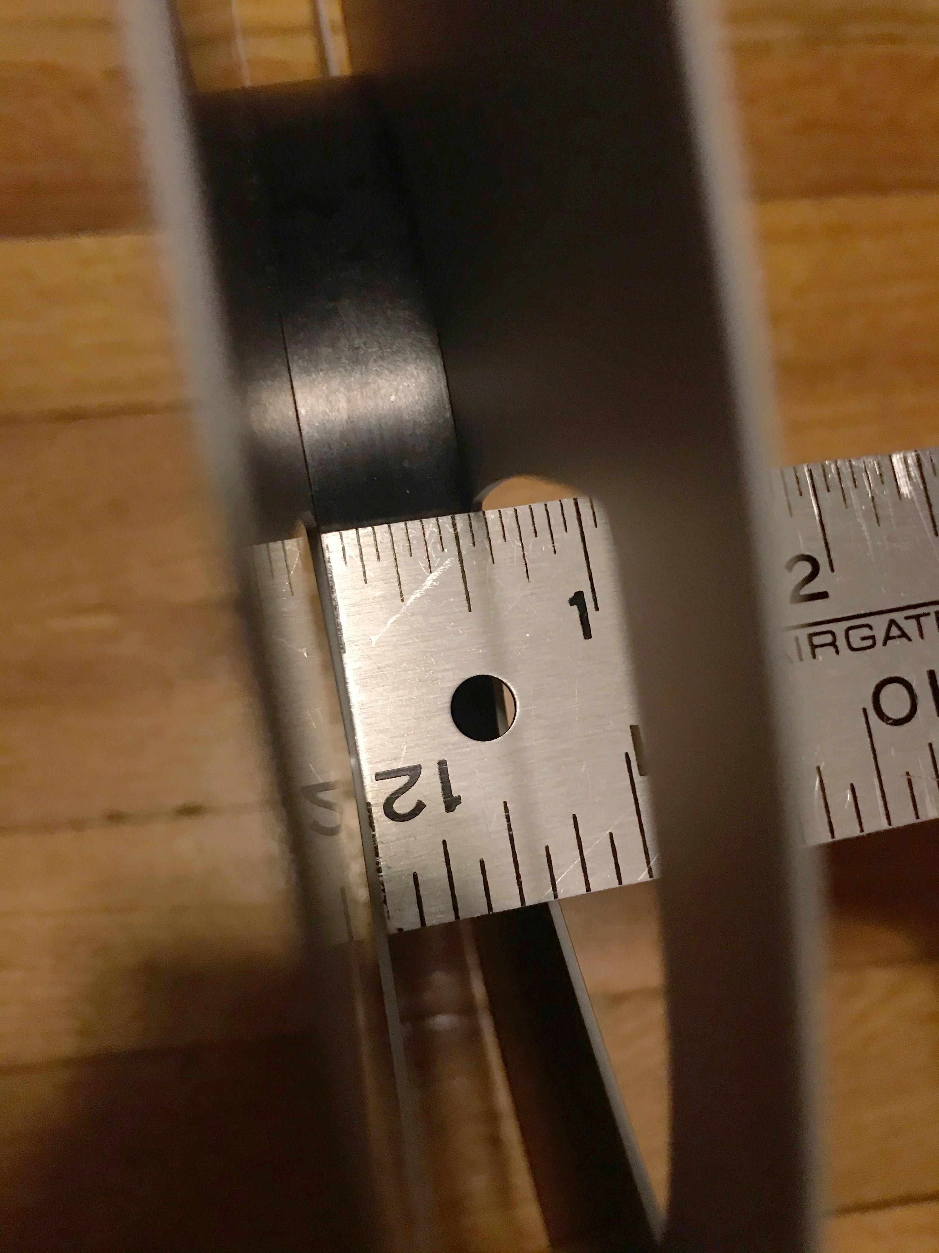

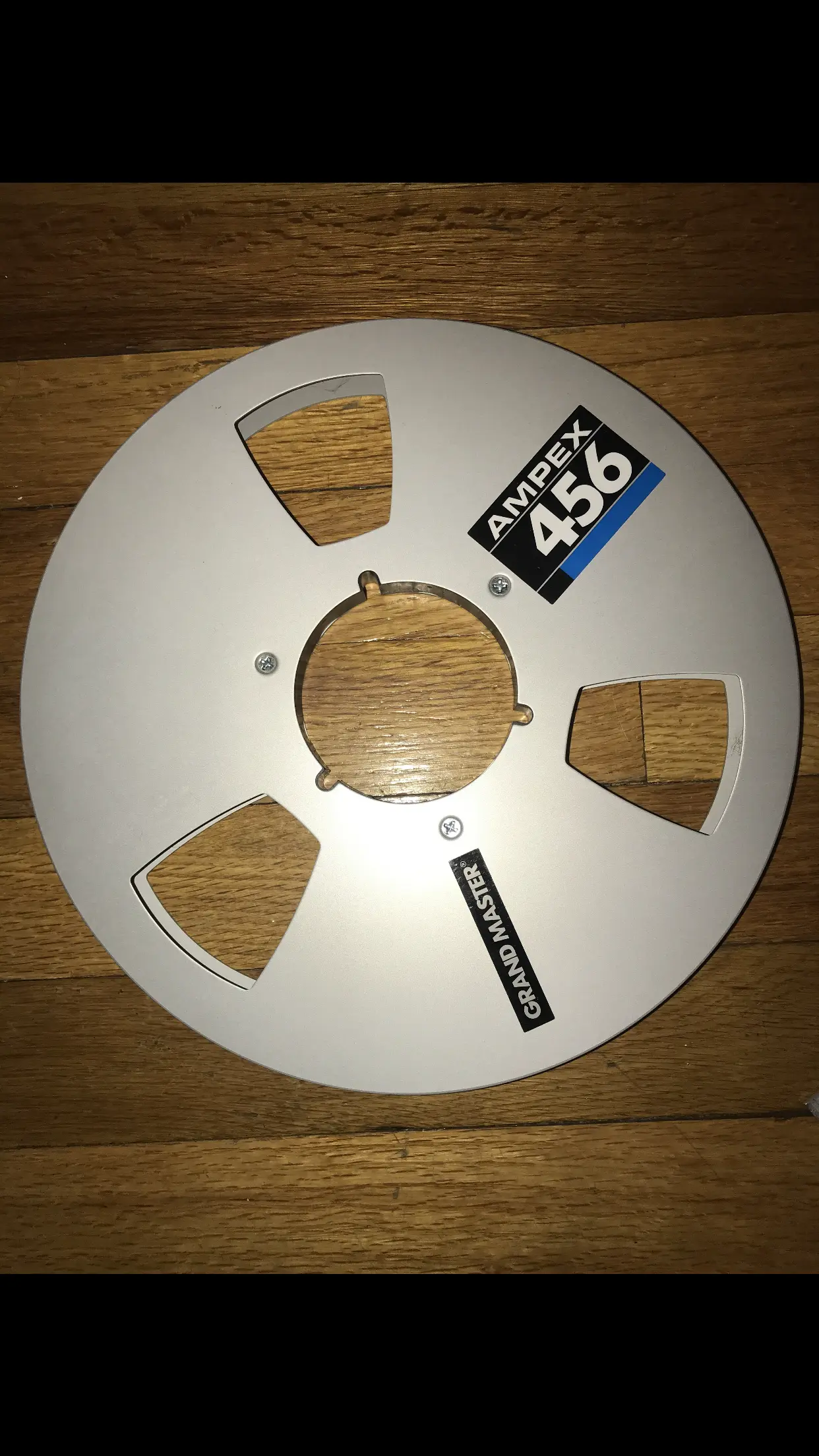

I just received a 10.5 inch take up reel in the mail that I'm planning to use with my Tascam 44. The seller said it was fit for 1/4" tape, but it clearly appears to be for 1/2". Will this take up reel be usable? Or does it have to be the same size as the tape? I'm using 1/4" RMG SM911.
No, the tape won't be kept in alignment and could get pulled into the gap.
Okay, thanks ... I just shipped it back. Getting a proper 1/4" reel now!
